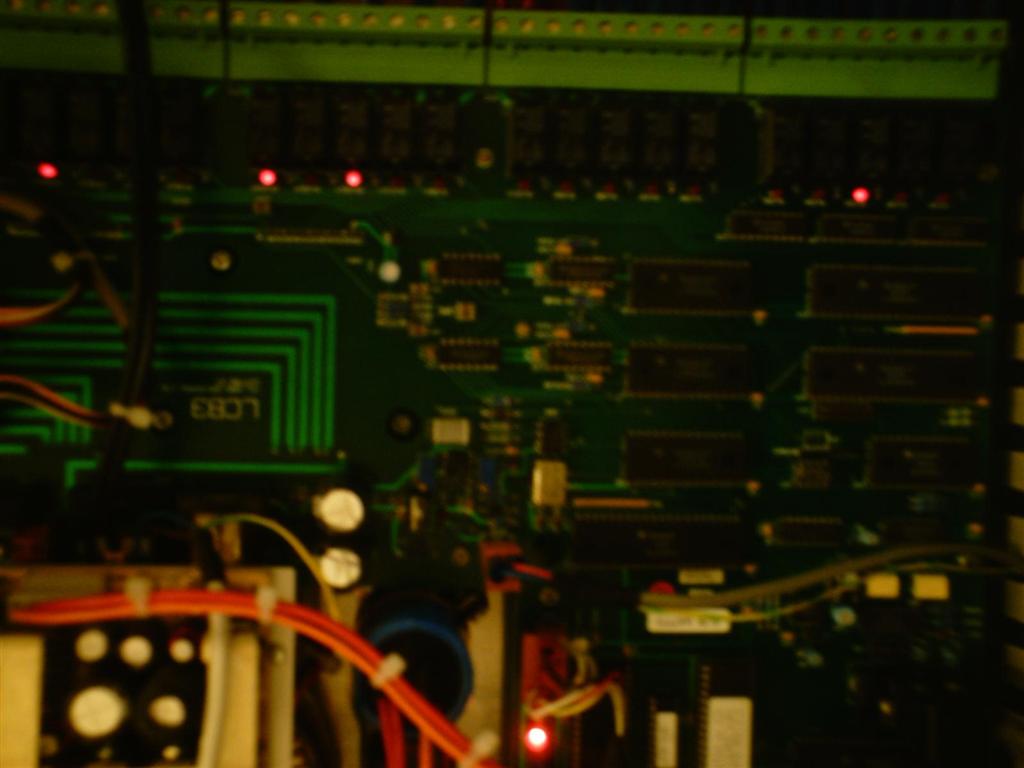

Have attached photo of board as not sure where jumbers are.
This board to my knowledge not been touched

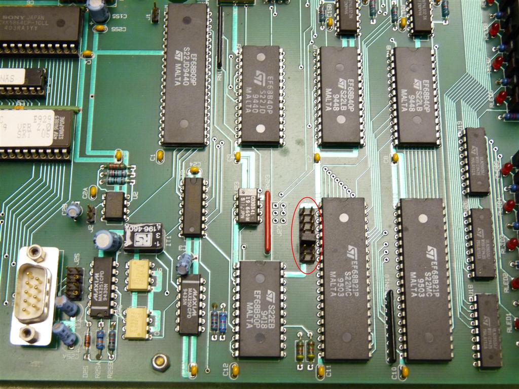

The record sheet for the Mirac serial number 30129D shows that it is fitted with a LCB3 control card & a Baruffaldi TOE80 6 station toolpost.
It states that the software version sent out was TOE80 V2.11. which seems strange. I am unable to locate the option file for this machine.
Is it possible to coppy the mirac.opt from one of the earlier discs?
I have attached a photo of where the links are on the LCB3 board but it does sound more like a software issue.
