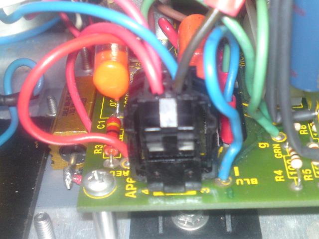

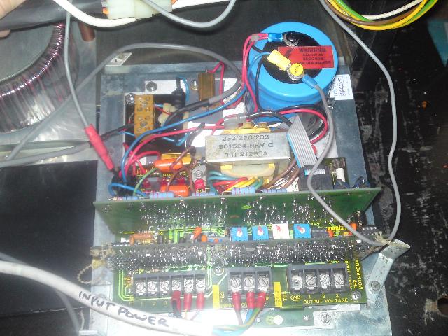

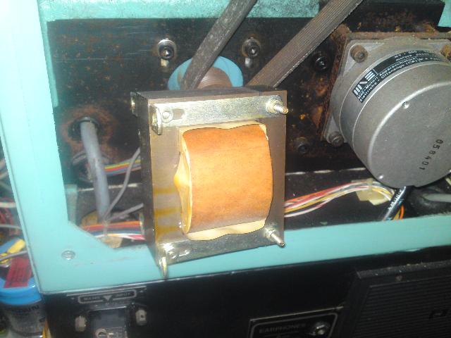

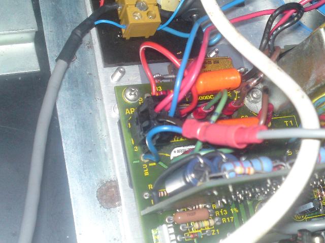

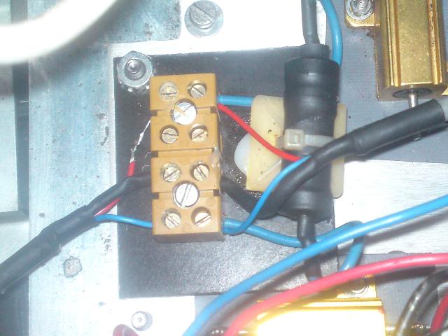

by the way the blue red and screened cable problem has been sorted thanks to you Martin. In the photos you can see where the transformer used to be there is what looks like a capacitor going across the red and blue cables. When you posh the spindle start in manual mode you can hear a relay click but the spindle just won't start up at all.

transformer in the end
connector block for TB1 parajust to PC1601 board
view of whole board. You can see the two grey wires that go to the transformer. And also where my two missing cables go in the top left of the board as you look at the picture.
Black connector again marked AP6 on the board
Black connector block on the parajust where you can see the bodge connection that goes to the transformer in the end!
