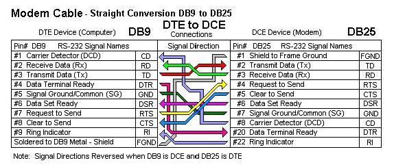

Micromill / Microturn. PC (9 Pin) to Machine (25 Pin) connection cable details
Modem Cable Micromill - Microturn - extrenal - 9 -25.JPG (49.66 KiB) Viewed 6063 times
