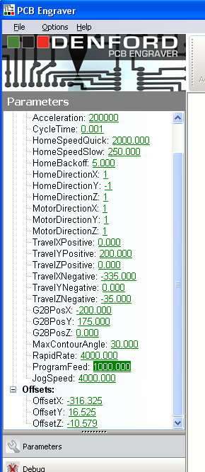

I am also unsure about setting the feed rate. When I used the default setting it moved far too quickly. By using the manual overide I could slow things down but it was more by luck and guesswork that what I ended up with seemed to work. Is there a table of feed rates recommended for the various cutters and drill sizes?

Because the PCB engraver was designed to be a simple control system, it has a fixed feedrate. Obviously you can alter the feed override to slow things down, but if you are doing much the same kind of jobs, and always need to reduce the feed, then you can change the default in parameters:
Goto menu Options > Setup Parameters enter denny as the password.
Click on Parameters and change the value for programfeed from 1000mm/min to something that works for you...

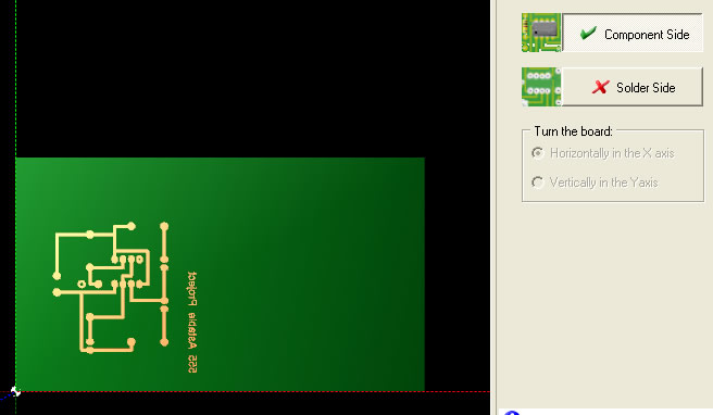

3. Flipping the board to display the track side correctly for machining seems to do so by turning it on the edge rather than the centre line, thereby moving it across. Can this be adjusted?
I think I understand what you mean by this...do you mean the mirroring of tracks should not move the position of them relative to the board ? see attached screenshots...
Re: User Manual?
Thanks for the further information. I am now the master of pan, zoom and tilt!
The screen shots do show what I mean by my question in point 3. My concern is that it leaves an inaccessible margin on the left hand side of the board although it may be that when the design is loaded for maching this blank area is ignored when it comes to positioning.
Regards,
Nick
Re: User Manual?
You can see the datum symbol on the board - at it's very bottom left corner. That is the same position that you set the datum in the software, so the board would be machined too far to the right. In my screenshot, the problem is exaggerated because I've increased the width of the board.
I'm trying to think of a reason why it mirrors this way...I do get the feeling that it is correct though, because if you wanted to machine the top side, then things wouldn't line up with the bottom machining :?
eg, if your board is 100mm wide and you put a hole 5mm in from the left and flip the board, then it must appear 95mm across from the left ....
Re: User Manual?
I believe it has to mirror in the way shown as the board could be double sided and the image has to mirror to line up with the top side.
To do this the board size would have to be accuratly measured and positioned.
If your only cutting single sided then set the board size automatically or manually to suround the tracks. Then flipping will be around the centre.
