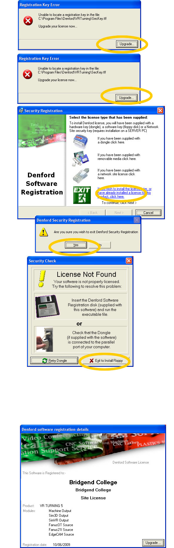

I have tried this loop myself by removing the seckey file (see screenshots)
When I put the seckey file back, though, it all works fine...
Can you double check the startin directory of the shortcut, or try running the software by clicking vrturn.exe directly from the C:\Program Files\Denford\VRTurning directory. All I can think is that the software is not able to locate the current directory because of a network/installation configuration
