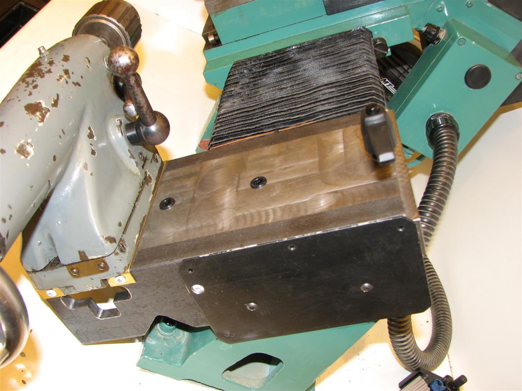

End view of adaptor in position with Mirac bed end cover replaced.

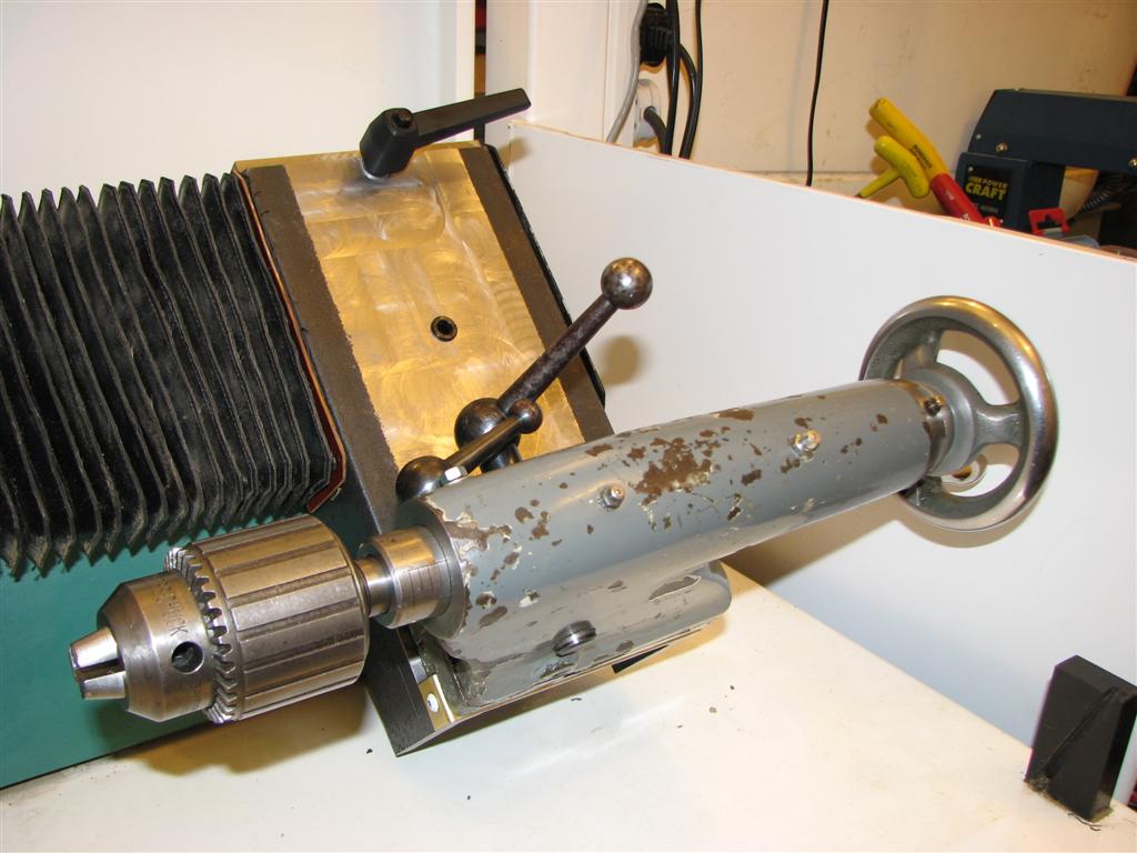

General view of adaptor and tailstock fitted.

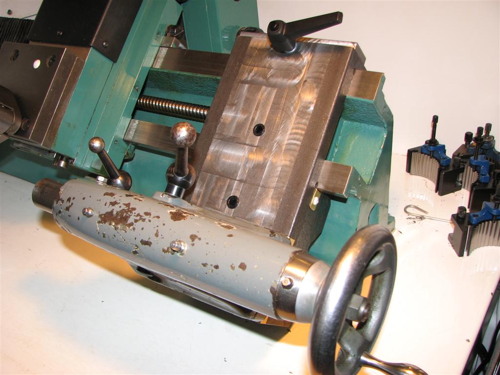

View showing adaptor in position without Mirac bed end plate in place
