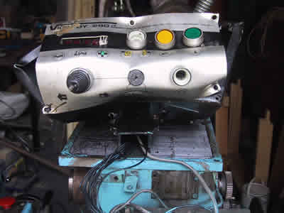

After... the control panel
Control Panel #1.jpg (11.08 KiB) Viewed 10335 times

A new box for the control panel was 'found' at work. Being a different shape, the original fascia plate wouldn't fit, and was pretty tatty after being flattened out. So I measured it up and re-drew all the graphics which were printed onto a self-adhesive film and stuck onto my newly made front plate.
A new mount for the control box was fabricated, then came the fun of wiring it all up - many wires had lost their markings so they all had to be traced back to the contactor board.
Finally it was all done and power applied from my home-built 3-phase converter. This was when I found out that these machines need 415V 3-ph - although the spindle and suds pump motors can be re-wired for 240V, the cut-outs can't be adjusted for the extra current and the vari-speed motor needs 415V or did doesn't have enough power to shift the Simplabelt pulley.
The 'tin work' was sorted by judicious use of a large hammer, big bits of wood and 6" G-clamps. There are a couple of dents still visible, but it all fits now and only gets covered in swarf anyway. Lathes aren't there to look pretty, are they?

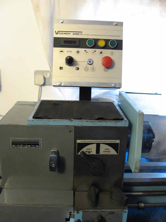

My new control box.
Yes, I can laugh at the state of the old one now too!
New control box in place. Everything cleaned-up, headstock cover plate fixed back on properly (all 4 screws had been sheared through), and replacement chuck-guard fitted.
Headstock & Control box #.jpg (21.9 KiB) Viewed 10314 times
New panel compared to the old, flattened-out, front plate.
New & old control panels#.jpg (24.49 KiB) Viewed 10314 times
