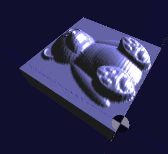

is there a self test routine or .fnc file that would put it through it’s paces
V2 milling will have installed teddy.fnc into My Documents\Denford\CNC Files - its an old favourite we used to test the speed of the machines (make sure you have Turbo mode on)
You need to find a block of foam 100 by 100 by 45 and a 1/4" ball nose.
