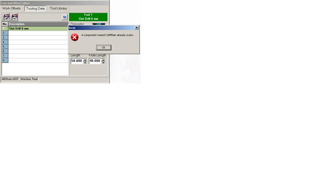

"A Component named CAMMain already exists" Error
A Customer Writes
I am getting a "A Component named CAMMain already exists" Error in VR milling Ver 5
CAMMain error.JPG (37.95 KiB) Viewed 4053 times
Re: "A Component named CAMMain already exists" Error
Administrator replies
I think this is something to do with another piece of software on the PC.
CAMMain is the name of the DXF import wizard form – my guess is that it is not being allowed to be created or shown for some reason – the exceptions are happening when the (none existent) form tries to close.
We have had school security software in the past which would not allow the VR Milling machine Control Panel to be shown (because it thought it was the system control panel because it had the same name)
This could be a similar situation.
Its worth making sure they are on the latest version of VR milling Ver 5 anyway…
