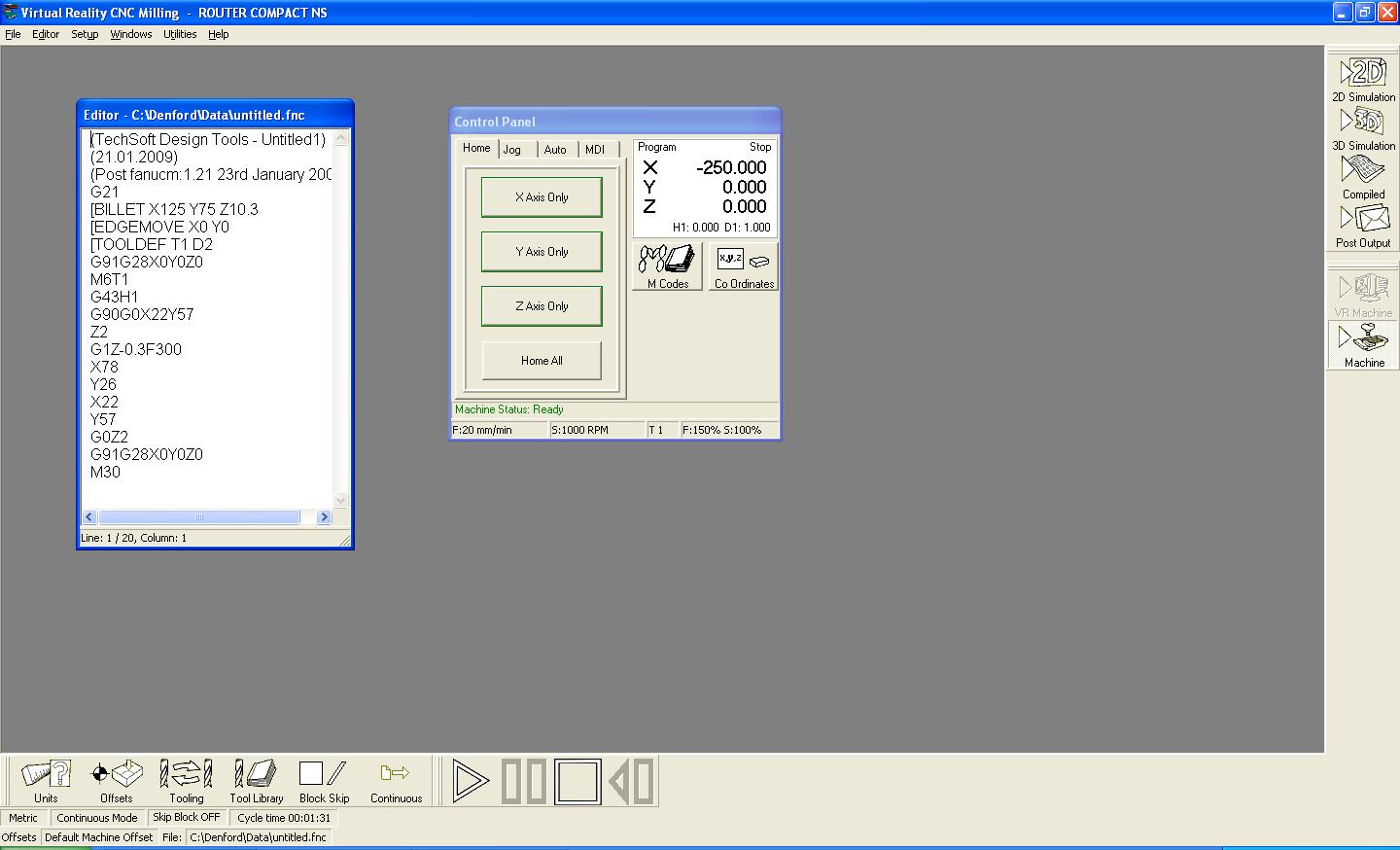

I am trying to setup one of the Microrouter Compacts to begin with, I launch 2D design and from setup select Denford Compact Router (i presume this is the correct choice) as my device. I am able to select plot and upon launching VR milling import the FNC and run the code on the machine. This is when the problem becomes apparent as the machine follows the design but the spindle does not spin.
Looking into the imported code there is no line in the code stating the spindle speed. Under the Pen/Tools settings in 2D design (within the PLOT window) The spindle speed is blank and gives no option to edit this, infact within the tool parameters the spindle speed is not even present.

Below are several screen shots which hopefully explain the issues a little clearer i have outlined in red the missing spindle speed option.
I can upload the fnc and dtd files if they will help further.
https://img201.imageshack.us/img201/2048 ... otedit.jpg
https://img209.imageshack.us/img209/8830 ... ngcode.jpg

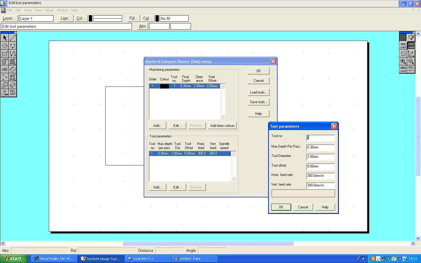

Can you add a spindle speed to the machine parameters in Techsoft?
From your first image the value looks to be blank.
Also have a look in the properties when you select plot. There may be something obvios.
That is exactly the problem. I am unable to add any spindle speed under the properties as it's blanked out. If i try and edit the tool the option is not even there.

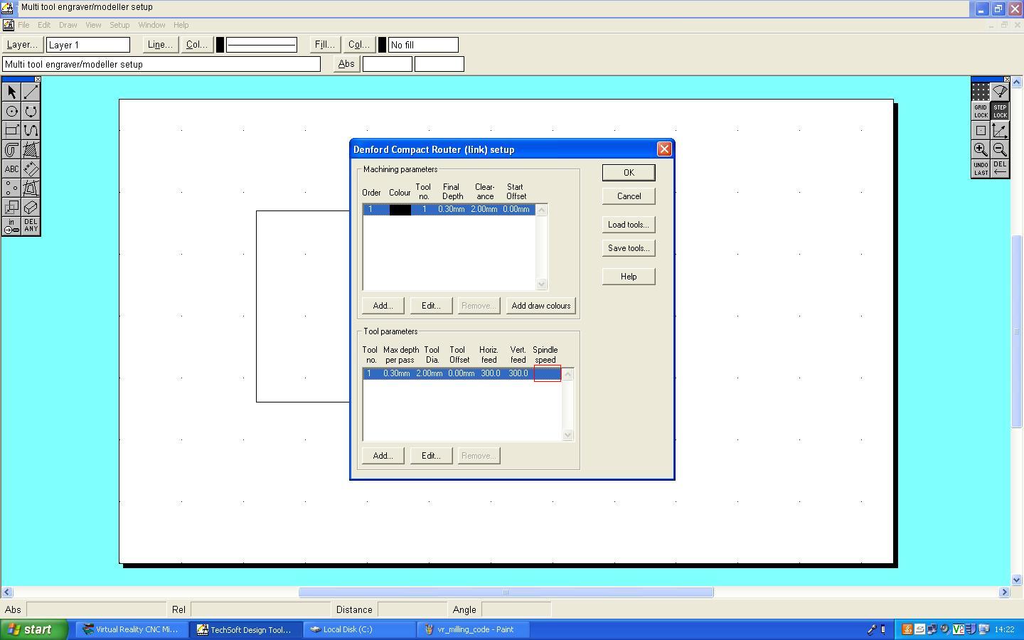

I believe the spindle speed entry should appear where i have drawn a red box.
See better res images below.
https://img300.imageshack.us/img300/2048 ... otedit.jpg
Obviously then when i export the file to VR milling it then has no spindle information so it will draw the design but never starts the spindle up.
