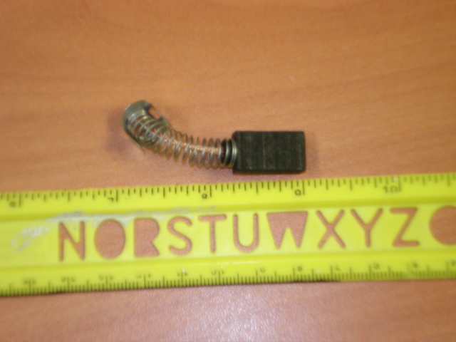

You can loosen the pinch bolt and remove the motor from the machine. The brushes are held in place by the two round slotted black caps.
The brushes are about 3/4” long each. If it is worn down to about half the size, you will need to replace them --- contact your local Porter-Cable / Dewalt / Black and Decker repair center.

Here is a photo of a new motor brush
