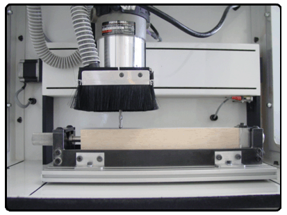

Does your machine already have the black brushes all around the motor mounting plate ?
As far as I know, thats the only method we have for containing the dust so that the vacuum can remove it from above.

This image shows the brushes.
Apperently, however, we have stopped fitting the brushes so I'm not sure whether a) we can still supply them or b) they would work anyway...I guess they were removed for a good reason !
I'm sure you could experiment with something, to see if you can contain the dust for long enough to let the vacuum suck it away.
