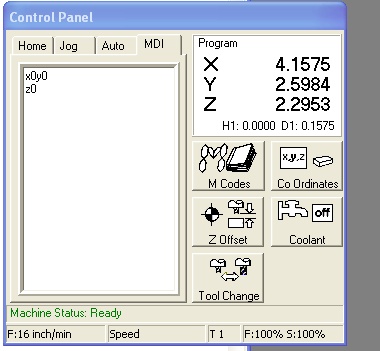

You can check the selected offsets by using the MDI (Manual Data Input) tab.
Click on the MDI tab and in the "White Box" type in
x0y0 (zeros) <enter>
z0
See attached jpg.
Then click on the Triangle "Start" button. The machine will move to Work Piece Offset that is "Active".
MDI Tab.jpg (45.99 KiB) Viewed 15713 times
Seemingly inexplicable move exceeds limits error messages are often caused by the Z tool length offset having been set my mistake..
Check the H value (next to the D value) in the control panel window, which is the active tool length offset.
(You'll see that its 0.000 in the above screenshot)
