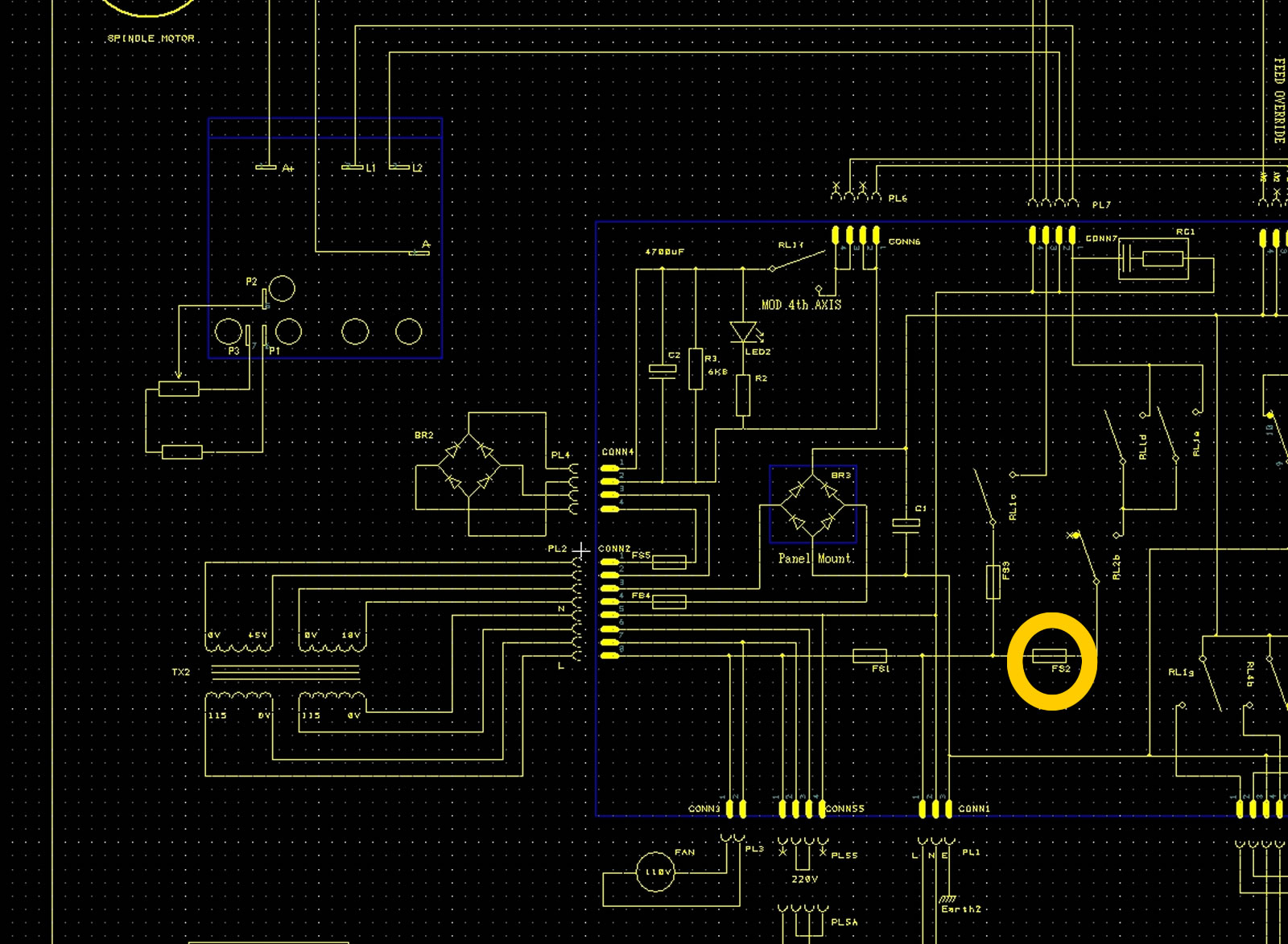

Here is the schematic and overview of spindle circuit.
The Fuse is FS2 and i think it should be a 10A F rated fuse.
vertical router schematic.jpg (338.41 KiB) Viewed 6543 times
