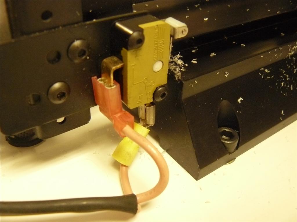

When we try to home the Micromill, the "Y" axis moves all the way to the back, away from the home switch. The wire broke away from the connector on the home switch, we installed a new push-on connector, but the "Y" axis still does not home.
Attached are photos.
There maybe two problems with your machine.
1 - The home switch is faulty. Replace it.
2 - The new connector looks like it is touching the terminal next to it (4). Use a connector with a plastic housing or slip a piece of heat shrink tubing over the connector to keep it from touching the terminal (4) or the machine. See photo.
