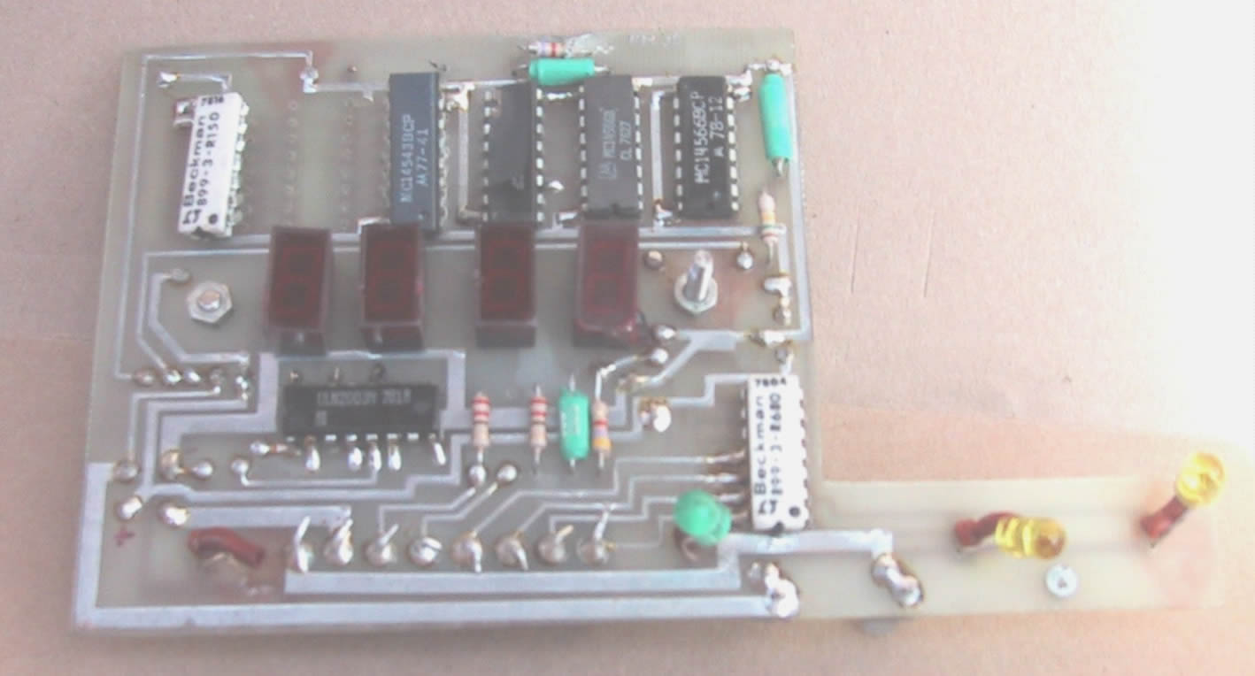

A couple of pictures to show the tacho circuit board variants to be found in the pendant controls.
The IC's are all readily available, but I have not managed to find a source for the numeric LED displays (one of mine has one bar that does not light up, but as it is the last digit and this always shows '0', it isn't really a problem).

Believed to be the earlier design
280VS tacho type 1.JPG (52.62 KiB) Viewed 15066 times
Believed to be the later design. There is one IC and a green LED totally missing in this pic, but has since been repaired to full working order.
280VS tacho type2 (damaged).jpg (82.15 KiB) Viewed 15066 times

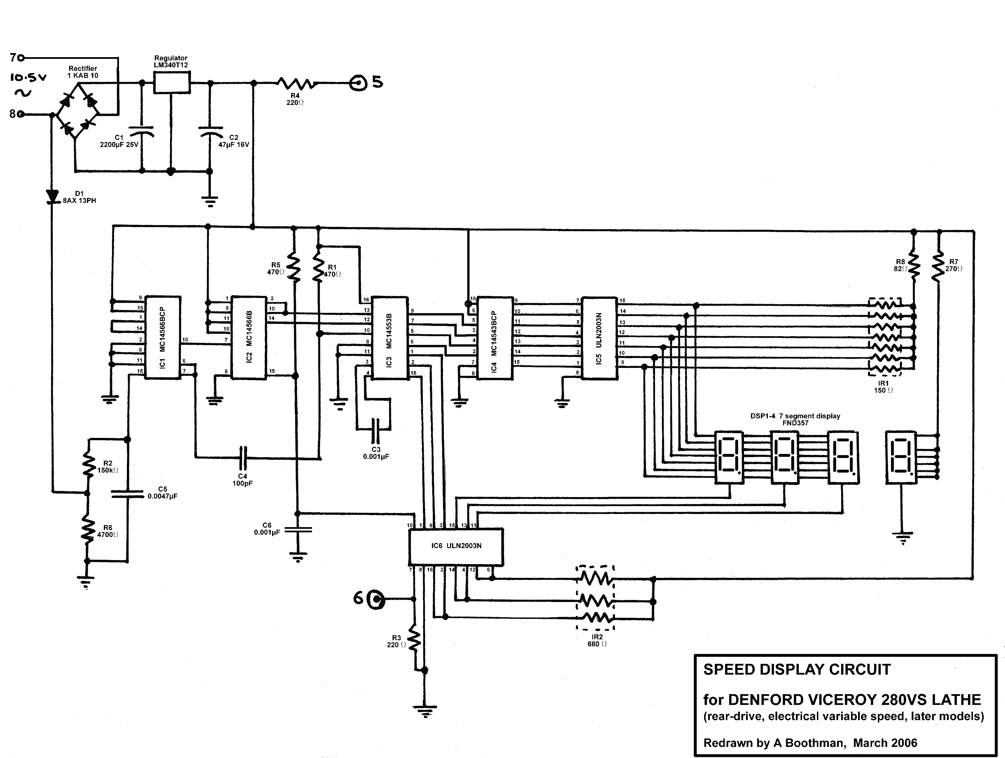

Attached is the schematic I drew up for the later type of circuit board.
As mentioned previously, yours should be essentially the same except for having transistors in place of the ULN2003N Darlington arrays and separate resistors in place of the resistor arrays (IR1 & IR2).
I compiled it from tracing the circuit board tracks - a tedious task but got me the answer as to what components I was missing!
It took me a while to work out the circuit logic (normally off, with a pulsed 'on' period) - you may well have a far better electrical knowledge than me, but if you want the benefit of my limited findings please ask.
Hope this helps
Schematic for type 2 circuit board
speed display circuit2.gif (105.72 KiB) Viewed 15055 times

anyway, after a quick looka at your very handy schematic it looks like the 4th display is wire to show 0 constantly? is that right? if it is then there must be a power problem somewere or that display would light up no matter what may be wrong with the I.C's.
maby its an earth fault :idea: shall do some checking at the weekend when im at the workshop armed with your diagram, was sure there was power though :?
although your diagram dosnt show the LED's, and they do indeed light up on command. tempted to go there now but im just in from work and its 20 miles away :lol:
any help describing the operation is welcome
I've uploaded the datasheet for the seven seg display here:
viewtopic.php?t=1940
Its hard to tell what the 4th display is hardwired to display without the pin numbers, but at least the datasheet will help you work it out...

Yes, the 4th (right hand) digit should always display '0'. But.... see note later.
I don't have all my info to hand, but if I remember right the 4 LEDs (2 green for speed change and 2 yellow for spindle direction) work off the 10.5V AC input - they do not use the rectified / voltage controlled supply that feeds the transistors, IC's, etc, so are not a test of that part of the circuit board.
So I'm sure it is a problem on the board somewhere.
Now, as I mentioned in my last post, the digit displays (all 4 of them) are 'pulse' lit - which is done by switching the 'ground' of the displays from V(in) to 0. So the time base generator IC's and the ground switching transistor must be working to get even the 4th digit to display '0'.
If you definitely have an output from the voltage regulator, I'm not sure how you would test the switching circuit without a scope -other than replacing components one at a time (I'm fortunate to have a very good local electronics shop that stocks transistors, etc - so its less than £5 to replace the timer IC's and the transistors).
Just compared the circuit board pictures again, and Chris' appears to be a 3rd variant, having a bank of resistors alongside the MC14511 LED driver IC.
So I'm guessing that in my 'type 1' picture, the 3 resistors on above the digit displays must be on the ground side (they look to be connected to the rail that goes to Vss on the time base generator IC's).
