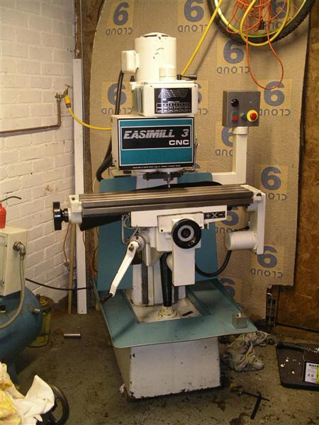

This Machine was purchased from a collage who’s Engineering Dept had been dissolved. I realised the 1980’s controller these machines came with are basic and needed replacing with a modern PC based system.
SPEC
3 Axis cnc milling machine + one spare axis on the controller
X = 375mm
Y = 175mm
Z = 70mm
Knee travel (Z) = 250mm
Throat movement (Y) = 200mm
Motor = 2PH inverter driven infinitely variable speeds 0 RPM to 3000 RPM
4 pulley ratios to alter the torque / speed characteristics
Size and weights
1,100mm wide
960mm Deep
1,750mm High
Weight = 450kg
Axis motors = Stepper motors driven by Astrosyn
https://www.astrosyn.co.uk/docs/P210.pdf
The machine was retrofitted with Flashcut CNC (£700) https://www.flashcutcnc.com/index.html
This system is better than Mach3 as the program data passes through a ‘black box’ that ensures the timing of the axis motors are perfect. + you have support from the flashcut engineers if you have technical problems.

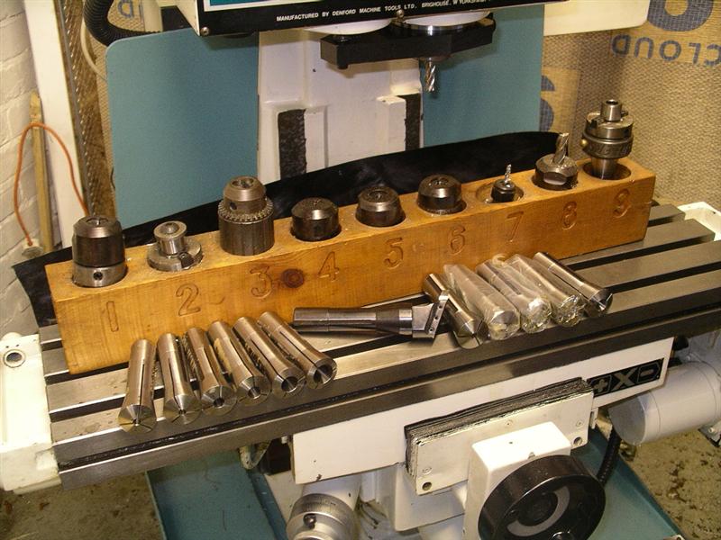

Tooling being sold with the machine (22 items):-
A range of quick release presetable tooling is included
5 x quick release holders with collets 6mm x 3 off, 10mm, 12mm
2 x Shell arbours
1 x Drill chuck
1 x limited access-machining holder with 6mm collet
R8 Collets = 12
6mm x 2 , 10mm, 12mm x 2, 16mm, 20mm
¼”, 3/8” ¾” 5/8” ½”
1 x fly cutter
The spindle can be tuned through the 180Degrees so drilling holes on an angle is no problem and the machine has a throat extension of 200mm that enables greater Y axis reach.
The machine is equipt with a Knee that gives 250mm of travel ontop of the 70mm Z movement
ALL the electrics / electronics were replaced, and if you are familiar with these machines you will know it was 415 Volt three phase machine originally, but due to carefully thought out conversion it now plugs into a domestic 240V 13Amp socket!!!
The drives were replaced with “NEW” Astrosyn Drives similar to gecko but a UK distributor (£300 for all three)
The spindle is R8 and is driven by a pulley and belt arrangement enabling slow speed high torque cuts to be made and high spindle speeds can be obtained, Additional to the conversion the 2HP motor is driven by an inverter (VFD) that allows infinite control of the motor speed… combine this with the pulley and belt arrangement it makes for a very flexible and powerful arrangement Enabling large cuts to be made.
Smaller Denford machines suffer with very weak spindles.

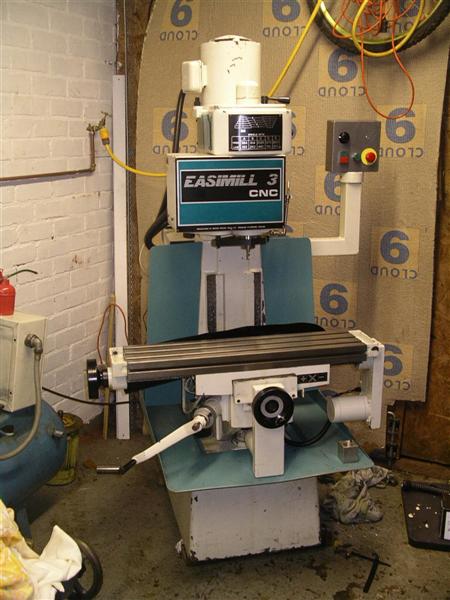

Knee Up
Knee Up
Knee Down
Knee Down

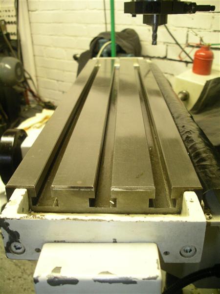

Table.... no marks or mistakes !

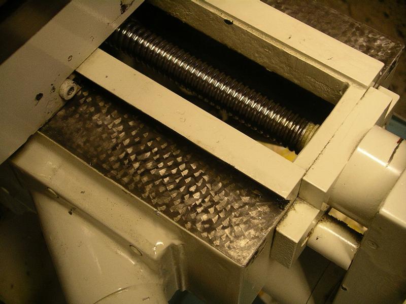

Slide and ball crew
Slide and ball crew
Tooling
Tooling

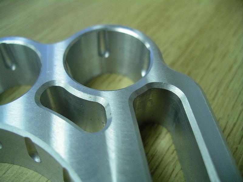

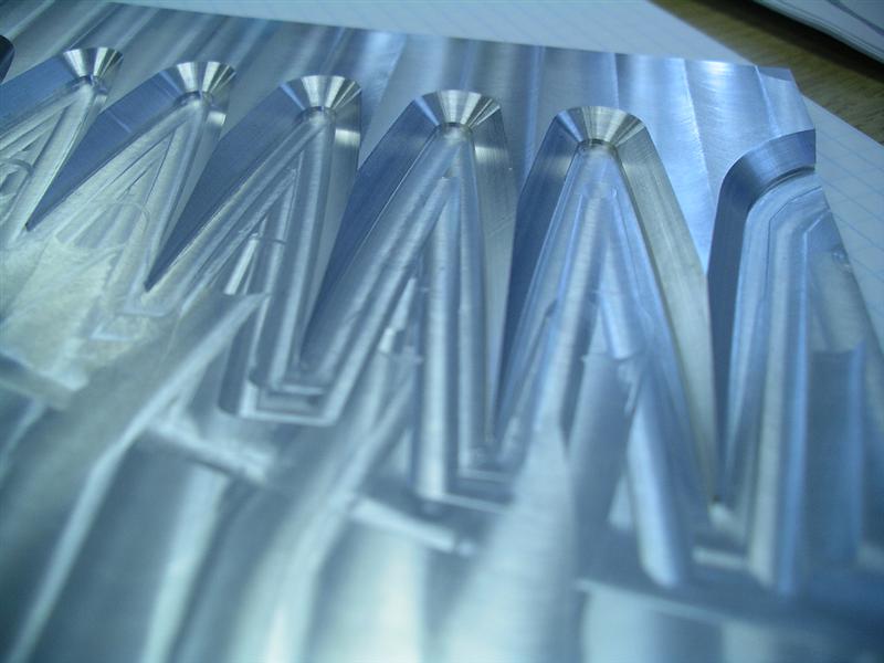

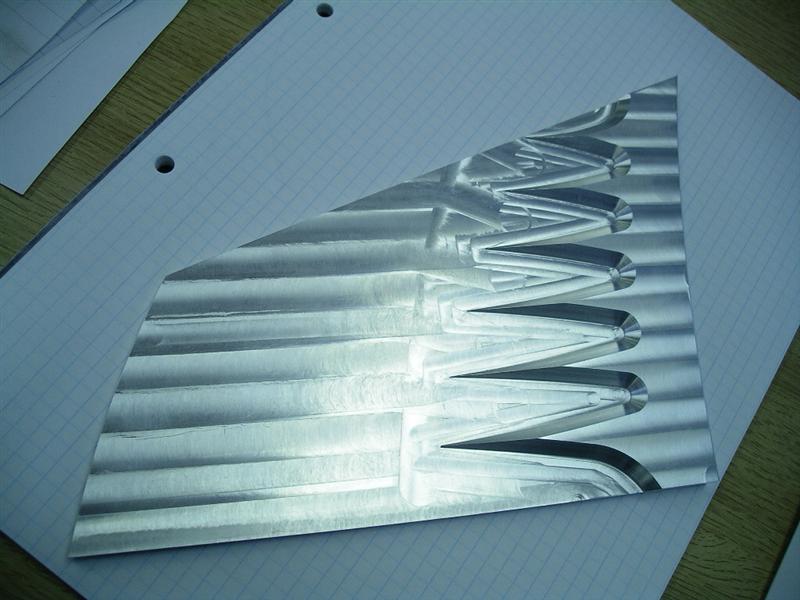

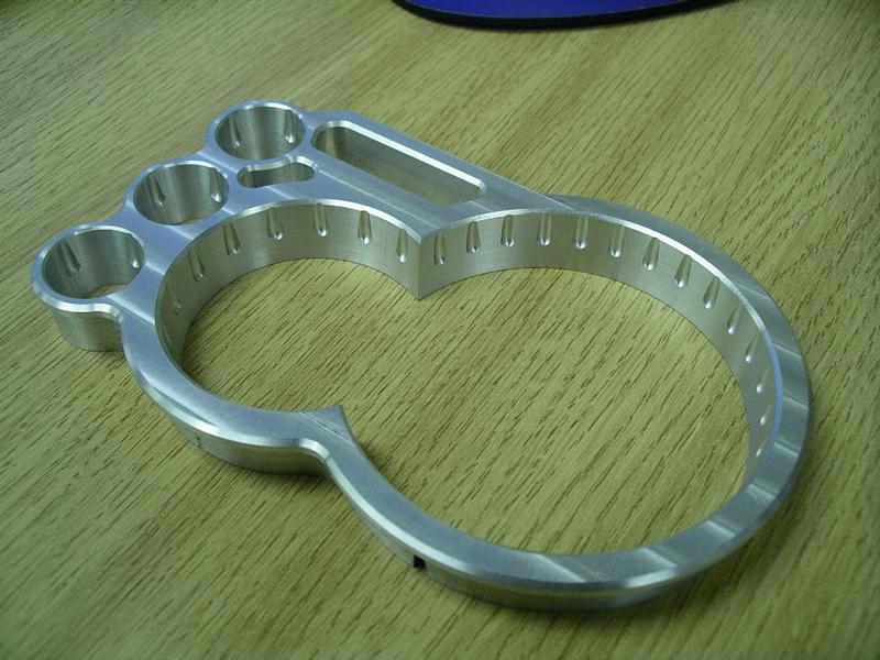

yea I've really enjoyed my denford...... i will attach some pics of stuff i've made.
