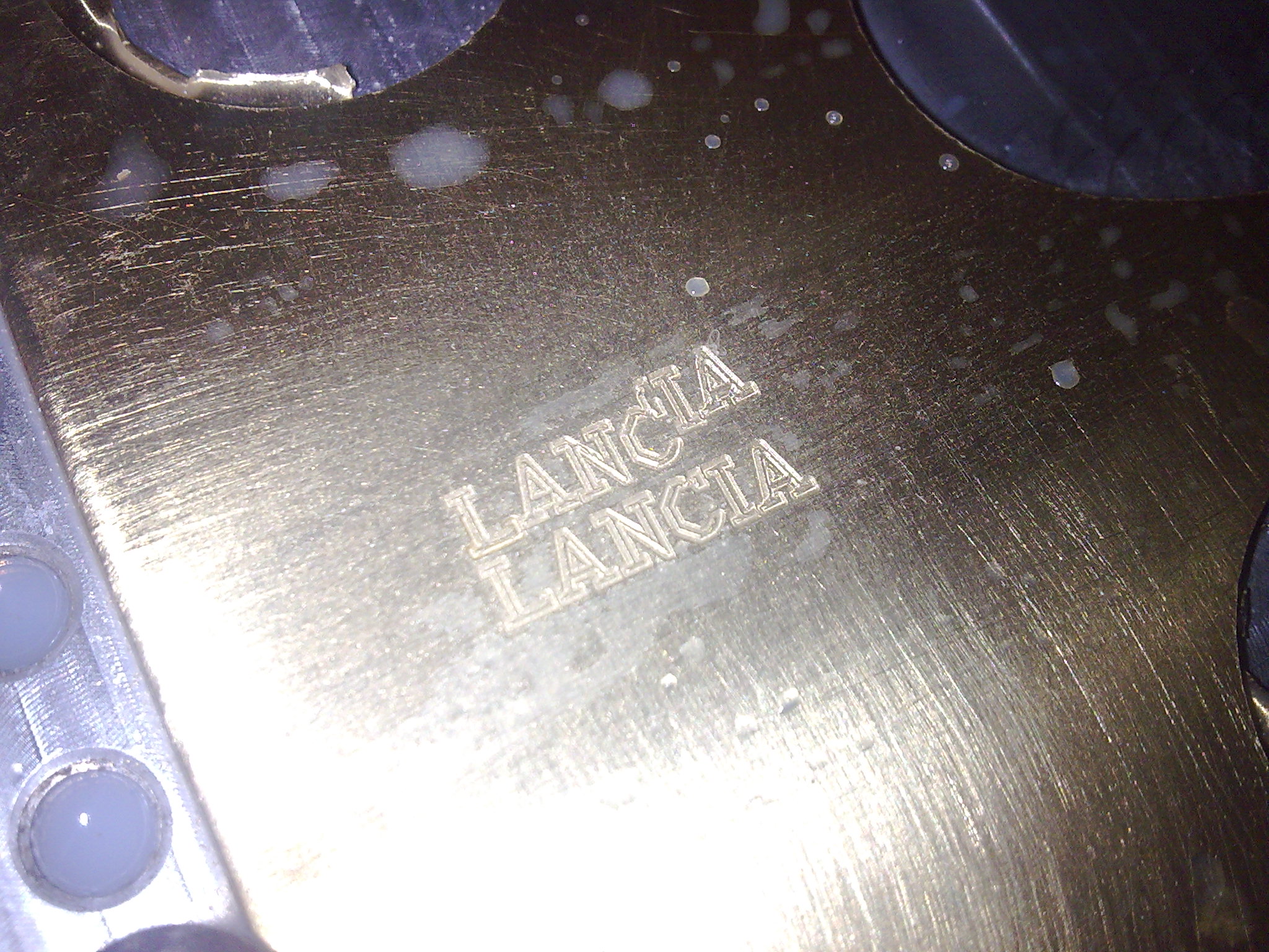

the pic
picture shows the engraving done with turbo and without - machining the same program notice the difference! i dont think its the gibs or motor sticking- checked the gibs and belt tension. its so closely machined and it still happens. think it must be software???? the euro card and axis drive were taken from a vmc triac would this have any effect??i have a 2000 triac pc the vmc was same year of manufacture.

It looks as if the axis is stalling. If it`s mounted in the same orientation as youre photo then it must be the Y axis. You will need to check for backlash & movement with a DTI. The normal way to cure it stalling is to tighten up the Gib strip slightly to allow for wear. It may be easier to drop the back cover off & turn the drive power off. You can then turn the Y axis motor pulley while adjusting the strip. You need to adjust the strip until the pulley resistance builds slightly.

its the x axis. backlash is fine. would not tightening the gib strip increase the chance of stalling?? extra stress on motor?? how do i know which is the z drive. my electrical is skill is minimal. how do i check the current?

The slides & stepper motors interact quite strangely. If the slide is too loose or tight then the stepper motor can stall or miss moves. I find that a good way to adjust the strip is to remove the x axis motor assembly & then tighten the strip while turning the lead screw until you feel a small amount of resistance.
I agree that it certainly looks like stalling - Martin knows best about the gib strips - I've no idea on that score.
Engraving text is probably the best thing to make the m/c stall - because the move blending was quite primitive, it could not look far enough ahead to slow the axes down around sharp corners. If you did some large spirals made up of small moves, then that would probably work great in Turbo. I think its the small sharp changes in direction that are making it stall when in Turbo mode - Out of Turbo every move is allowed to accel and decel, and dosn't stall.
You may be able to improve it by setting up the slides, but am sure the newer USB control will improve its contouring ability a great deal.
