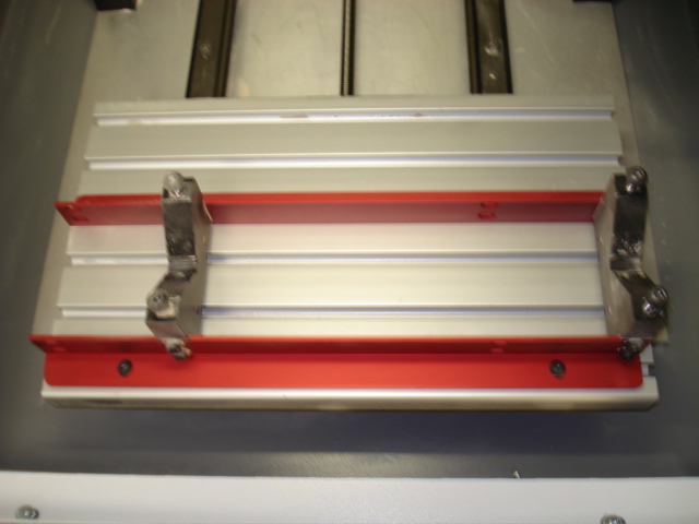

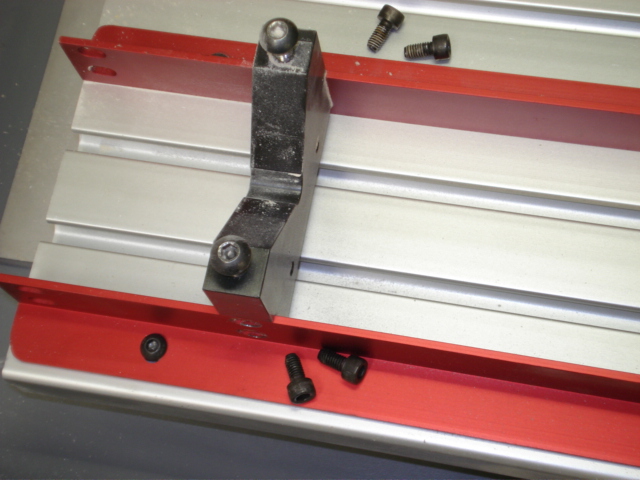

Tighten the 4 bolts keeping the V-block square to the table and side rails.

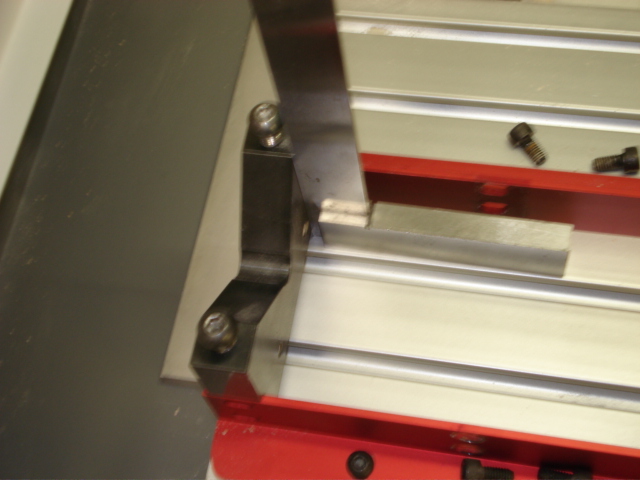

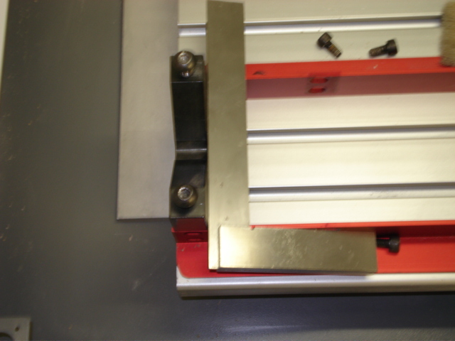

Use a square to align the V-block with the table.
Move the block to the end of the fixture and use a square to align the block with the side rails.

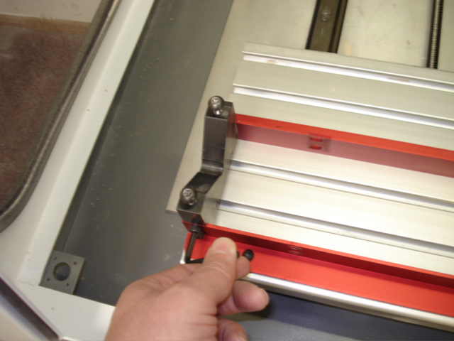

Remove the 4 bolts from the V-block.

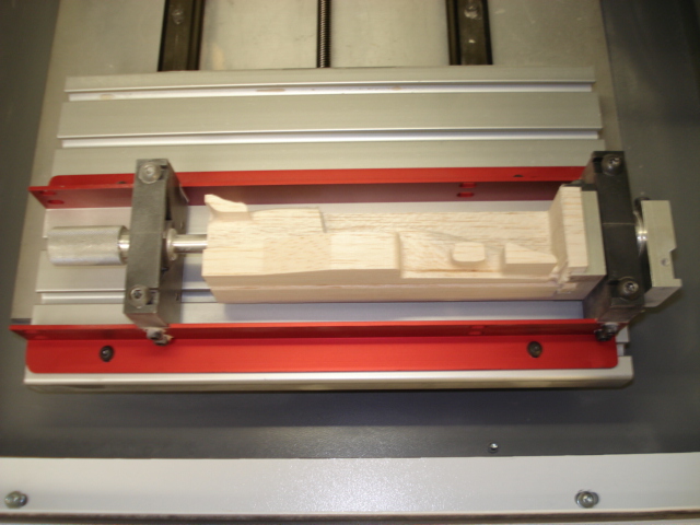

Remove the F1 block assembly from the jig.
Loosen the straps that hold the F1 block assembly to the jig.

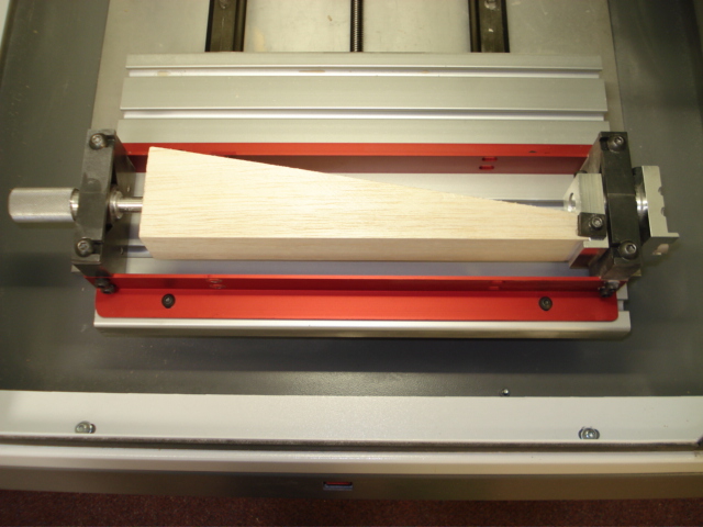

More photos to finish up the conversion.
There is a Word Document at the end with some Hints and Tips for using the Denford Co2 Car Fixture.

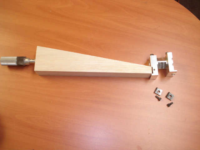

Tighten the straps to hold the Dragster assembly in th jig.

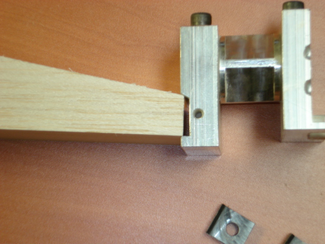

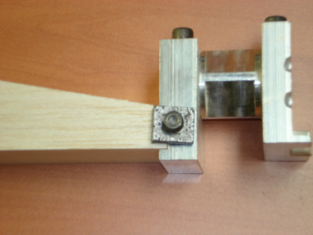

Tighten the clamps to hold the front of the block to the nose plate.
Sand or file the front of the block to fit the nose plate.
The front of the block must fit tight in the nose plate.
Remove the clamps from the top of the F1 nose plate.
