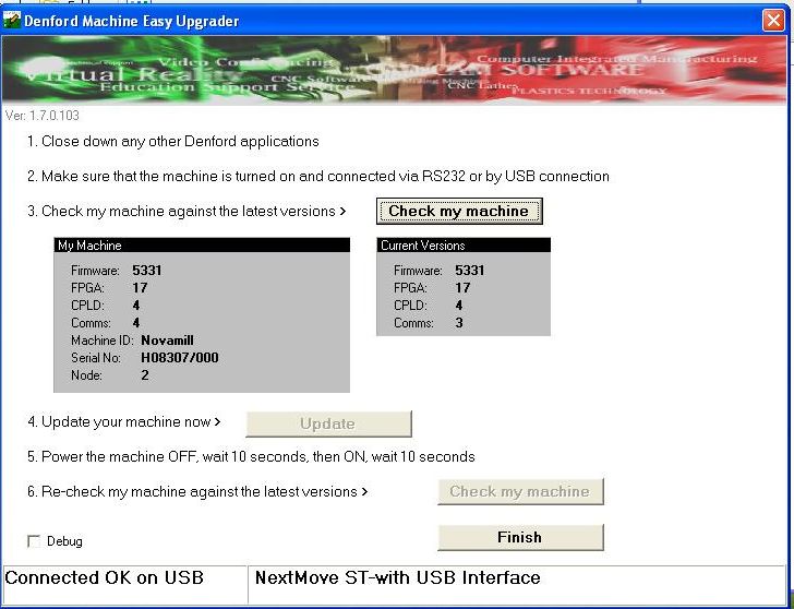

The machine type (ie NOVAMILL) setting is programmed into the Baldor top board by easyupgrader.
Thanks for the reply. We have had the Baldor USB board changed recently. The easy upgrader is saying that the machine is a novamill. How do we change this?
Thanks.
Tim
easyupgrader 2.jpg (70.01 KiB) Viewed 6679 times
Its ok - I pm'd the password you need to get into the machine type editing (not denny) - he replies saying it worked ok and all is good now
