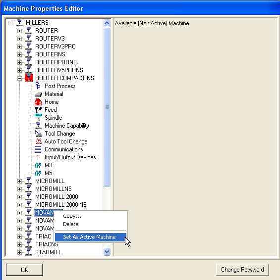

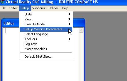

If so the way to change the machine type is to select Setup option on the top menu bar. Then select the Machine parameters option.
You will be asked for a password which is "denny"
You then have a list of all the machines and can right click on the NovaMill and then set as active.

Some screen shots for above.
change machine.jpg (37.33 KiB) Viewed 6725 times
edit machine type.jpg (15.32 KiB) Viewed 6725 times
