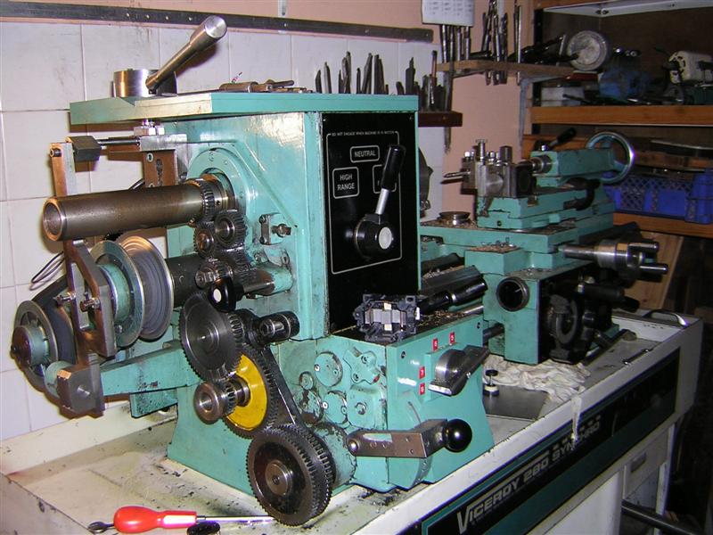

The assembly drawing for the drive is MVS 100/200 - but I'm not sure it will help you too much, but maybe Admin can scan it for you.
Attached is the equivalent drawing for the Synchro model, along with a picture - I think all the variable speed models used the same pulley set, just mounted in different ways.
I have taken the pullies apart on mine a while ago, but I can't remember exactly how I did it now apart from using a pair of g-clamps to prevent the sprung pulley from flying apart when I undid the retaining bolt/washer.
Hope this helps a bit.
Synchro drive arrangement photo

Thanks Andy,
though the setup on the synchro is different than ours, the principle is the same. It gives me confidence to sort ours out. I suspect the thrust bearing seized on ours in the past sometime and that some there was some collateral damage too. I'll send pictures on Monday if I remember to bring my camera to work.
