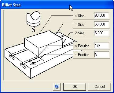

To move the billet on the bed of the virtual machine press shift then drag the part with the left mouse button.
At the end you get the box to change billet and datum position.
Try with the values shown
The billet has to be positioned on the machine table and the offsets have to be set for the Virtual Machine, just like in using the real machine.
When using the Virtual machine, click on the Setup tab, Default Billet Size. Here you can define the size of the billet and the position on the table. You can jog the machine to bring the cutting tool to the datum position, the billet will turn red when the cutter touches it, open the offset window and set the offsets OR click on the blue banner of the “VR – 3D – 2D Simulations” window then click on the Simulations tab, click on Auto Datum. Click on the Simulations tab again and click on Datum Position. Select the Datum Position(s) you are using.
