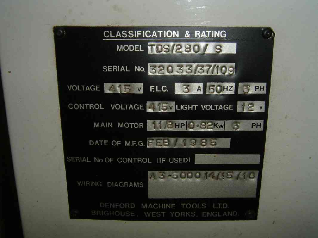

Some (all?) of the 280 Synchros have a plate on the front of the contactor box (centre of the cabinet stand).
The one I have a picture of shows the wiring diagram numbers A3/500014, 15 & 16.
A quick search of the sketch book index lists drawings SK633 (3 phase) and SK634 (1 phase) as 'Synchro Lathe Wiring diagram', along with SK641 "Synchro - Control box Wiring, 3 Phase"
Should be possible to work it out from a combination of these I would think.
Synchro plate.jpg (40.11 KiB) Viewed 12652 times

I'm afraid that my photographic skills don't match yours, my photo of the ID plate is difficult to readm so I've, hopefully, attached the details to this reply. hope it works

DETAILS ON THE INDENTIFICATION PLATE FOR THE DENFORD VICEROY SYNCHRO.doc
If this is not sufficient Andy do please let me know
(19 KiB) Downloaded 1094 times

No, I didn't expect you to have those drawings - but hopefully Bradders can find them in the dusty old drawing chests!
Please send me a private message with your email address, then I will pass it on to one or two of the contacts I have with a similar lathe. It was one of them who took the picture I used, and I'm sure he would take a few pictures or trace a few wires in his machine to help you out.
