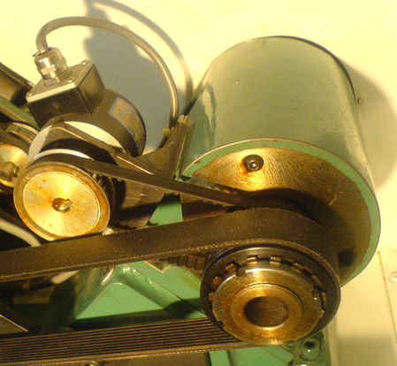

Here's the encoder:

spindle encoder - indexing
I'm looking into using the z channel on the spindle encoder to signal the one ppr that mach 3 requires for spindle control. Apparently mach 3 doesn't support more than 1 pulse so I won't be to make use of the 60 ppr signals generated by the A/B channels.
So, I'm curious... does anyone know what the LCB3 controller was doing with the A, B and Z channels from the encoder? Or rather, what was the purpose of the indexing (z) channel in this application? How did the LCB3 specifically make use of the encoder's indexing feature?
The index pulse is only used during threading. The controller needs to know the orientation of the spindle so that the position of the spindle is the same for each threading pass.
And it uses the 60ppr to measure spindle speed.
Hope this helps!
Thank you Magoo... that's great! I mostly just wanted to know what I was giving up by possibly letting go of the 60ppr channel with the upgrade. My most obvious concern was losing any threading capabilities so this is good news. So the 60ppr must also be used to indicate direction as well then I would assume.
In this case it is only used for speed (the B phase of the encoder isn't used)
I presume that Mach will still be able to calculate spindle speed from the index pulse - it will just be less accurate.
I'm also guessing that you won't be able to do threading in Mach if you ditched the single pulse and retained the 60ppr signal ?
- unless Mach can keep counting up to 60 and therefore knows when to start the next threading pass ?
I found out that the spindle encoder functions at 5v (input/output) so theoretically it could work w/ mach using the 1 ppr indexing channel. I am told that mach is unable to read more than 1 ppr and so it seems like an ideal match to me. If the 1 ppr indexing channel was originally setup to control threading and mach is designed to utilize 1 ppr for threading control then why shouldn't it work?
Someone at the mach forums mentioned that the 1 ppr signal may be too short for mach to register it through a parallel port. But, I was planning on using the Grex's ethernet port to send the signals back to mach so I wonder if this could make the difference? :?
