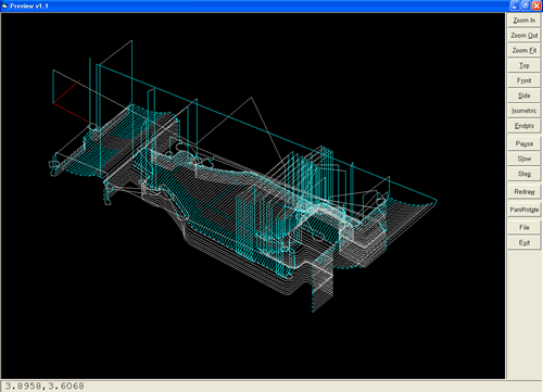

Proof that it works...
An F1 car toolpath produced by Denford QuickCAM Pro being previewed in G Code Interface for Davinci and C-series (Techno Inc)

Techno Post
Denford Admin wrote:A new post processor file has been added to allow our software to create G Code for the Techno machines
techno-g-code.ppl
Download the above file, and put it into this directory:
C:\Documents and Settings\All Users\Application Data\Denford\Posts
