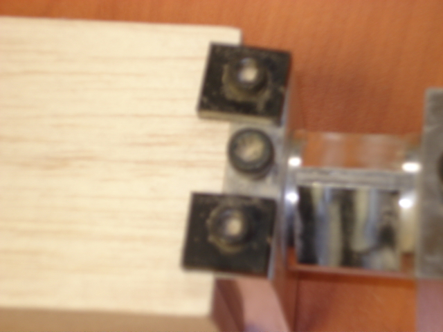

I notice that the dragster blank seems to be moving around too much in the fixture on the tapered end. I tried really pushing things together when I set it up, but it is still moving about 4-5 mm when machining. Any ideas?
Compact 1000 - F1/Dragster Fixture - Blank Moving

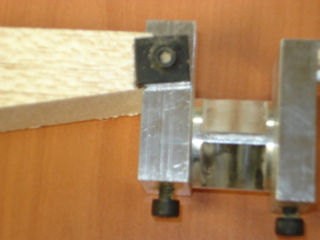

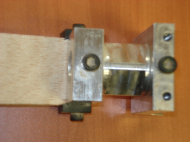

You need to use the same small hold downs that you use with the F1 attachment and you should be good to go!
Attached are photos of the nose block using the black clamps to hold an F1 balsa block and a Dragster balsa block.
