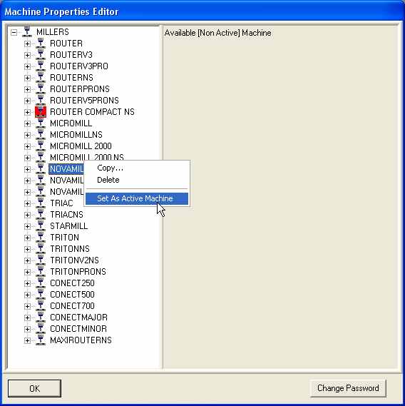

Go to setup machine paramiters.
Then type the password "denny"

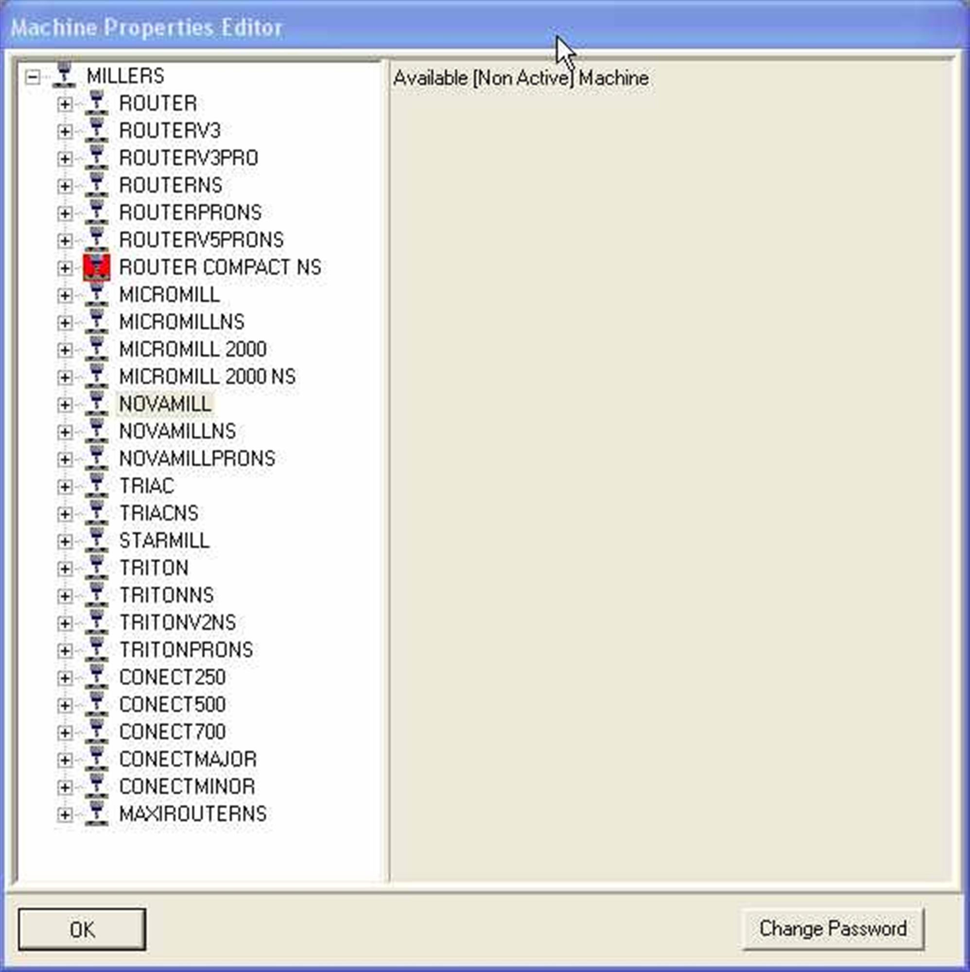

See the attached screens that show the machine choices in VR Milling.
Select NovaMill (Not NS) :!:
The right click and make the machien active.
I've done all the above and now it's stuck on 0%
any more suggestions?
Having just spoken with you your machine is now up and running! :D
