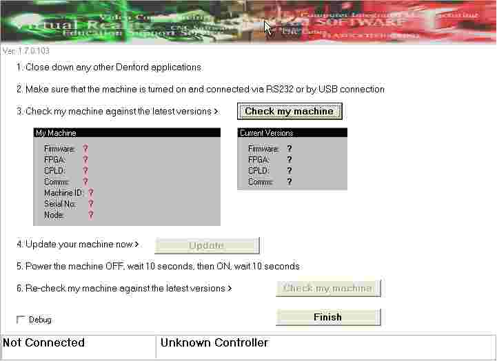

Download the latest easy upgrader software from our download site and run this.
This will let you check the firmware and update as required.
If it says no controller found then the board is at fault. It should communicate and check the firmware. If it does follow the prompts and update if required.
Once done then the VR should communicate OK.

I am using USB with Version 2.31.3.951. When I plug in the usb it is found by XP, but the upgrader is unable to find a machine. How do I go about getting a replacement controller? :?:

Open the easy upgrader software.
From the opening window move your mouse over the top of the red and green banner at the top of the screen shown in screen 1 and double click.
You will now get a new window open that allows you to try and force a firmware update.
If the firmware updates successfully then the machine should now connect correctly and all is OK.
If it is still unable to communicate then you will require a replacement card.
Make the changes to upgrade by USB and identify the card as shown in screen 2 then click on the force firmware
Double click to open the force firmware menu
select the correct card type
