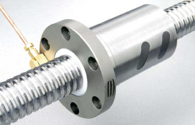

Hi, I can't be exact as I don't know the machine, but you will find them hiding behind the slideway covers / bellows (if it had any ?)
The oiling point may be some place away from the nut, and fed by copper pipe (see photo of generic ballscrew and nut)
