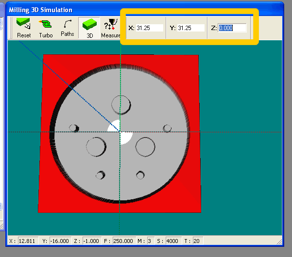

In v2 milling you can shift the position of the datum in 3D simulation to get a better idea of what the finished part will look like:
This is the kind of program I created which used a round part with a centre datum position:
And the simulation looks OK, when you shift the datum position:
Shift the 3D datum position so you can "see" the moves that would normally be outside the billet

I was getting confused because I did'nt zero the machine offsets before I took the 'circle centre' ones. I havent got the x y boxes in the 3d sim window to move the datum ?
Click on the 3D simulation window to make it active,
then the menu appears at the top: 3D Setup
Click this, and tick Use Offsets
