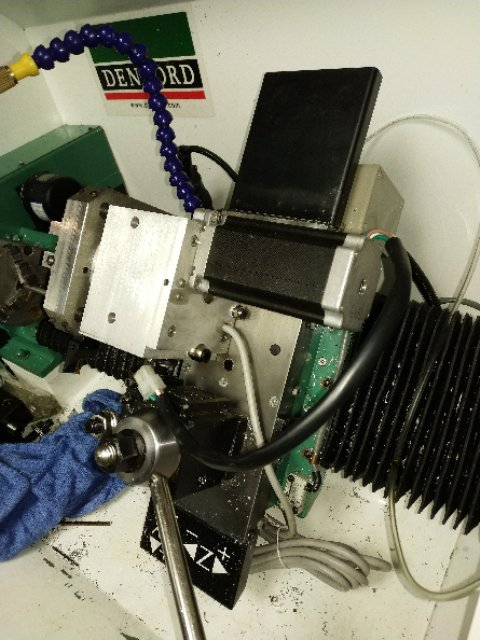

Re: NovaTurn Servo retrofit AMD Gizmosphere iBOB2 PCIe x1
Hi all. I am still looking for a turret for the NovaTurn. I am in the process of adapting a EMCO turret. In addition I am looking at having the NovaTurn Turret manufactured from the drawings with changes. The changes will include a AC servo and absolute encoder.
I have been very busy on other projects. Please contact me if there is still interest in the system I have designed.
Thanks,
Iron-Man

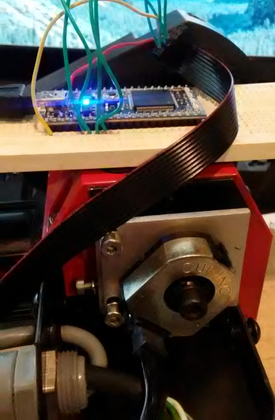

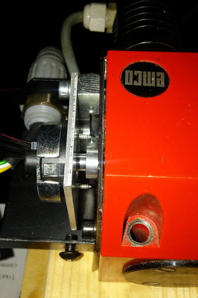

I started my conversion of a EMCO Tool Turret a few weeks ago.
STATUS:
EMCO Compact 55 Tool Changer modified with a AMT203 ABS Encoder with SPI interface.
ARM LPC1768.
The encoder interface is now working.
Denford NovaTurn AC Servo Lathe used to make new encoder adapter.
The set-up uses the existing tool changer board. I am in the process of designing new board to replace the EMCO, that will have its own motor driver.
Next step is PathPilot interface to MESA 7i77.
Iron-Man
