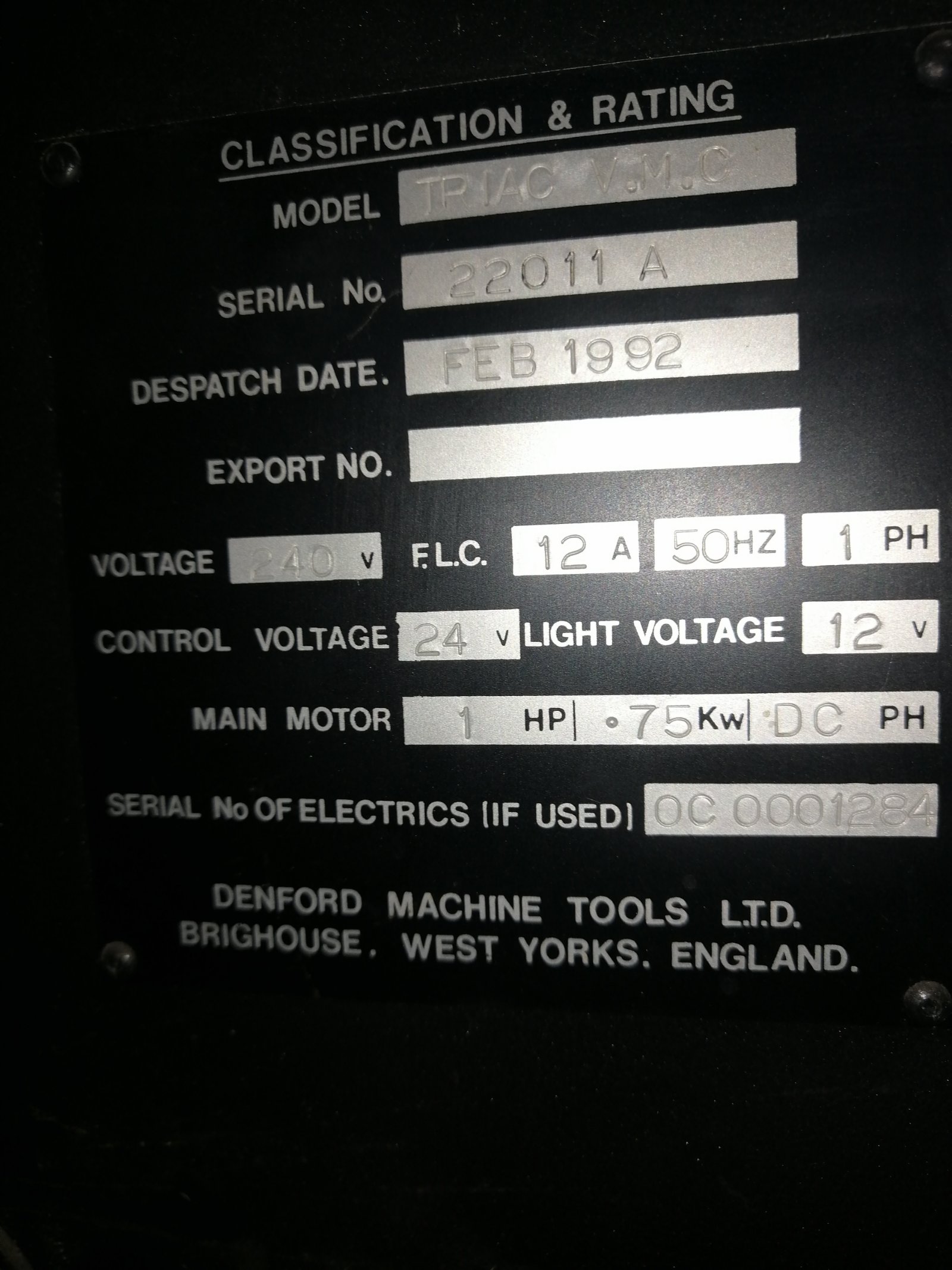

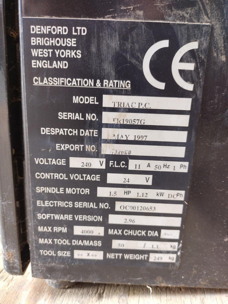

have also included pictures of the rating plates on the two control boxes

Would anybody be able to tell me which set of electrical drawings would apply to the newer control box which has an electrical serial number of:-
OC00120653
as the set of drawings that I have downloaded (1997 electrical drawings) seem to have 4 sets of drawings non of which seem to tie up with the above serial number

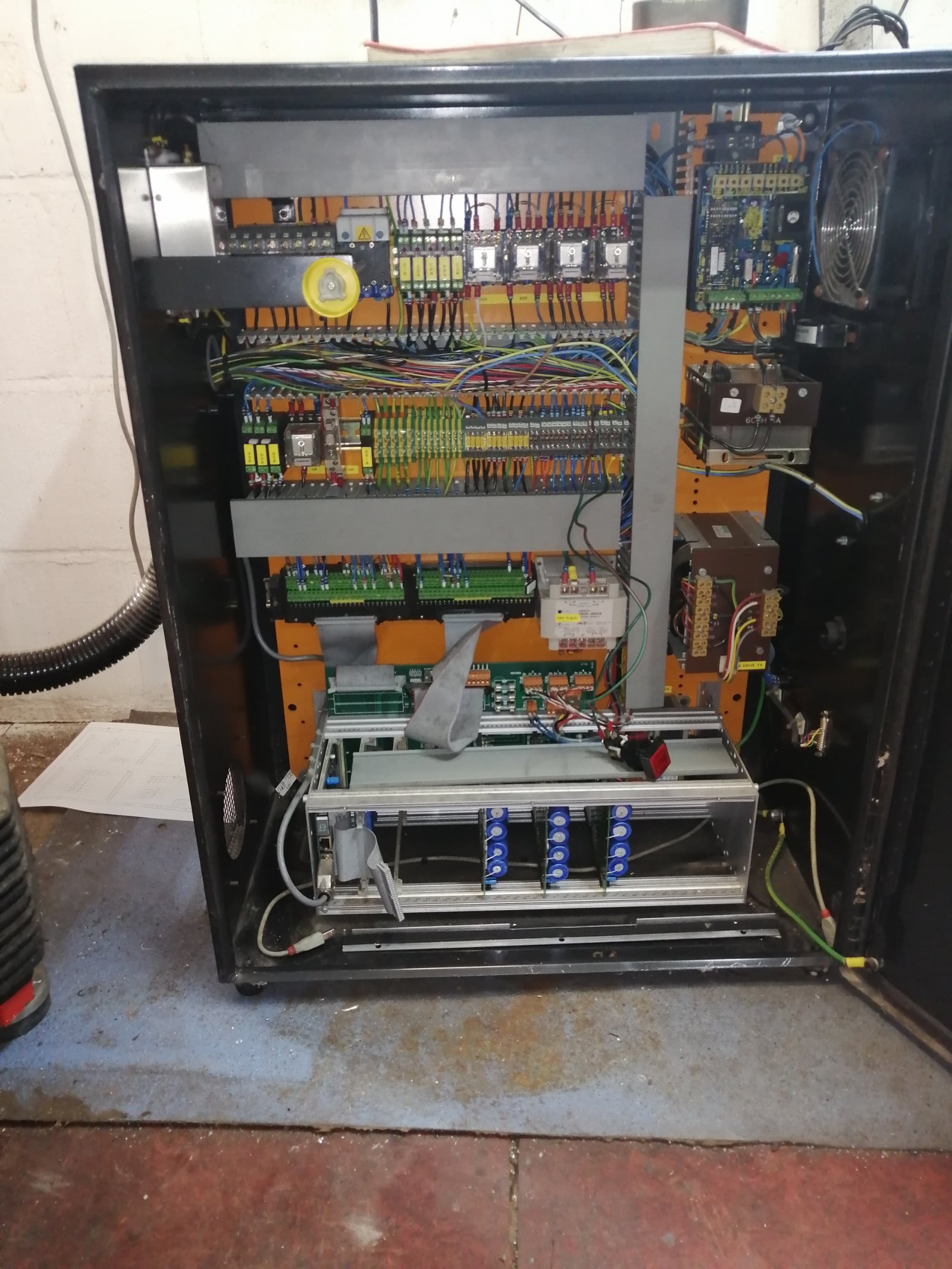

Here is a picture of the inside of the control box the extra temporary switch sitting on the bottom rack was fitted to simulate the machine E stop
circuit that we thought was missing this did give us the 24v supply to the control that we needed but unfortunatley it also seems to have disabled
the limits / home functions so when an axis was sent to reference it would not stop and would crash at the end of travel
the control is to be used via usb from vr milling 5

I haven't seen the later drawings but have been through the ones for my 1995 Triac PC and the E stop circuit that powers the ESR has the various limit switches, E stop, pressure switch (if fitted), and other items like spindle motor thermal all daisy chained together so if one item goes open the ESR relay drop out. If you've added that new switch to provide 24V to the ESR then it won't see the limit switches open while your new switch is closed. Sounds like you need to find out what is open in that chain and take appropriate action. The datum sensors on mine are NAMUR sensors and are powered from +12V and IIRC sensed by the control card and not part of the ESR circuit. Whether that's the same on yours I don't know. I did find that when adding some new wires into the flexible conduit for a rotary axis, my control box seems to have all the wires installed for an ATC even though one was never fitted.
