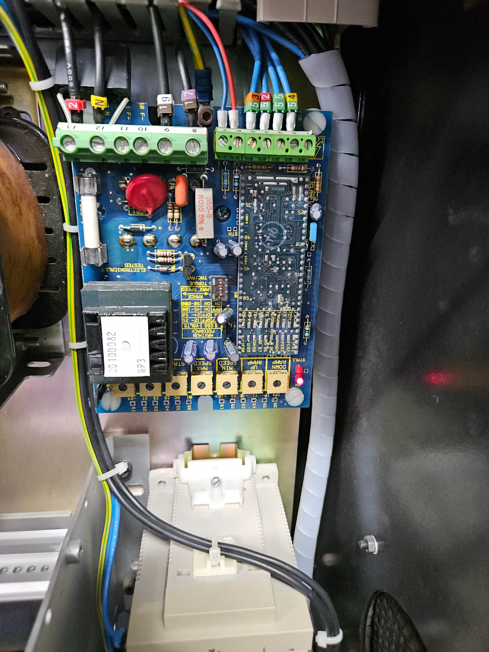

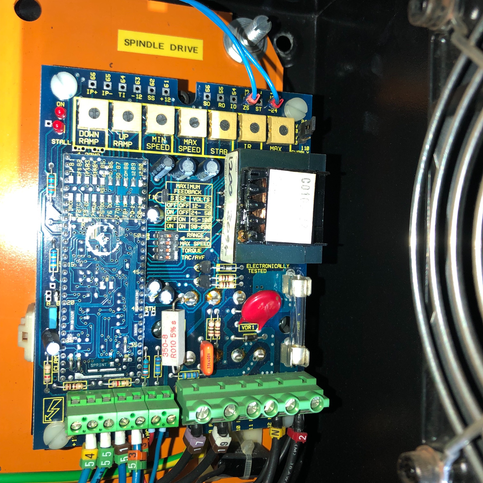

Does the red power light on the Sprint 1200 spindle drive light. It may be as simple as a fuse.
Re: Triac Spindle (Won’t rotate)
Is it the LEDs at top left that you mean? Or somewhere else?
I’ve not had chance to fire up this week, but will try over wknd! :)
Martin,
Neither of the red LEDs illuminate…

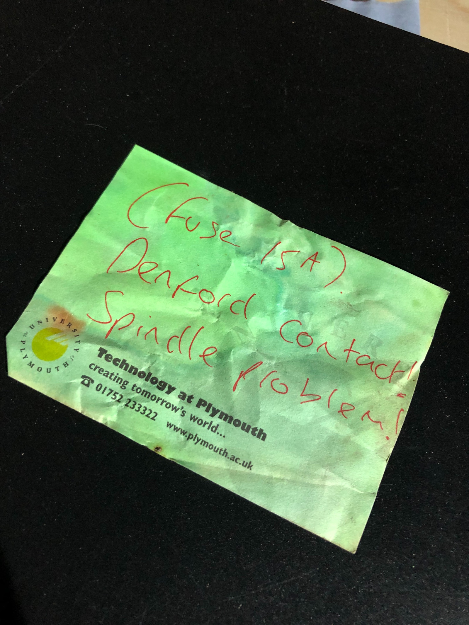

I found the attached ‘post-it’ in a manual that was supplied with the machine… so the spindle fault was a pre-existing condition it seems!
(I’ve never had it running since I bought it).

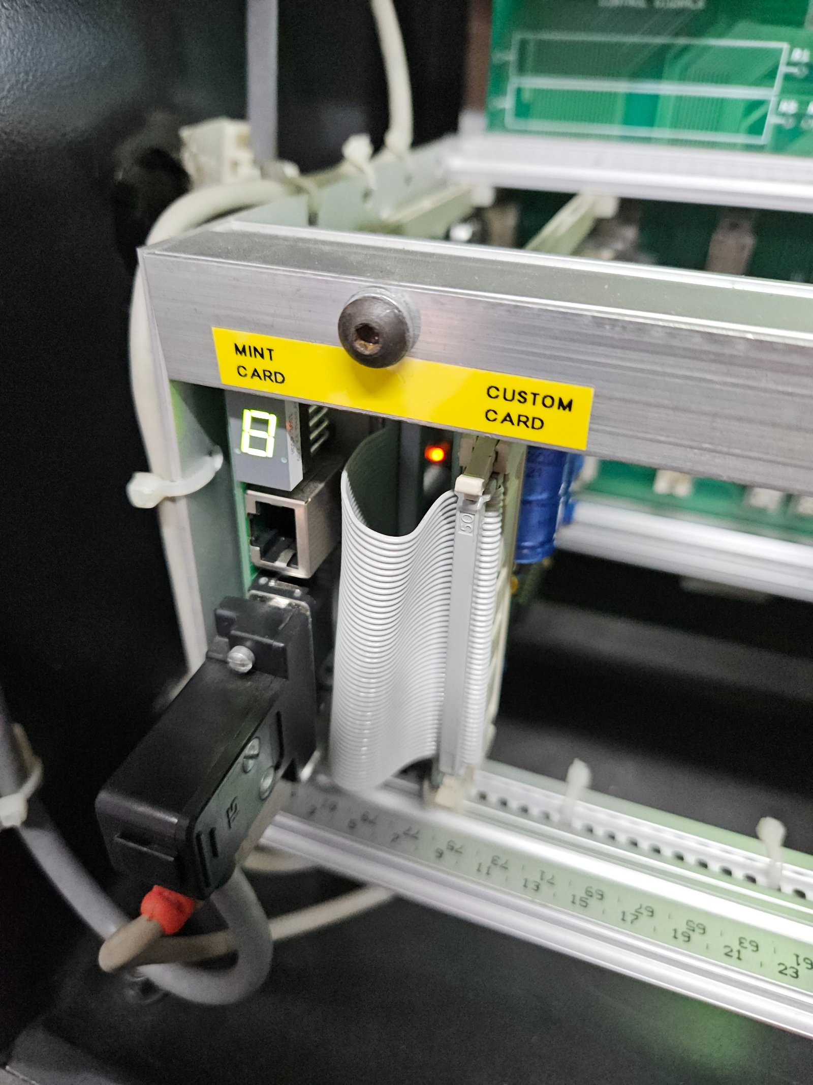

The two Blue wires with the numbered tags on them that are in positions 2 and 3 in the Green connector at the bottom of the drive shown in your photo are the 0~10v Analog input to the drive, depending on what spindle speed is selected this voltage changes, normally the Max spindle speed on a Triac is 4000rpm for the full 10v so if you disconect the wires from the drive and set a spindle speed of say 2000rpm via your MDI and measure the voltage you should have 5v at that point, if you have the correct voltages for programmed spindle speeds the the input is OK and you will likely have a "duff" Sprint Drive.
If the input from the main board is not OK at the input point of the Sprint drive then you likely have a Main board issue that is not outputting the voltage for the Spindle drive, I am not familiar with the Denford hardware for the VR software so wouldn`t like to guess at a diagnosis, contact Denford is probably best if that seems to be where the issue is.
These old drives are easily damaged as they were a "non-isolated" type, the new version of that drive is fully isolated and last I checked was about £260 direct from Sprint Electric, Model number for use in the Triac is the 1220, that is what I used when I had to replace one and it has worked perfectly, link to Sprint website for the drive. Looks different but the connections are the same :)

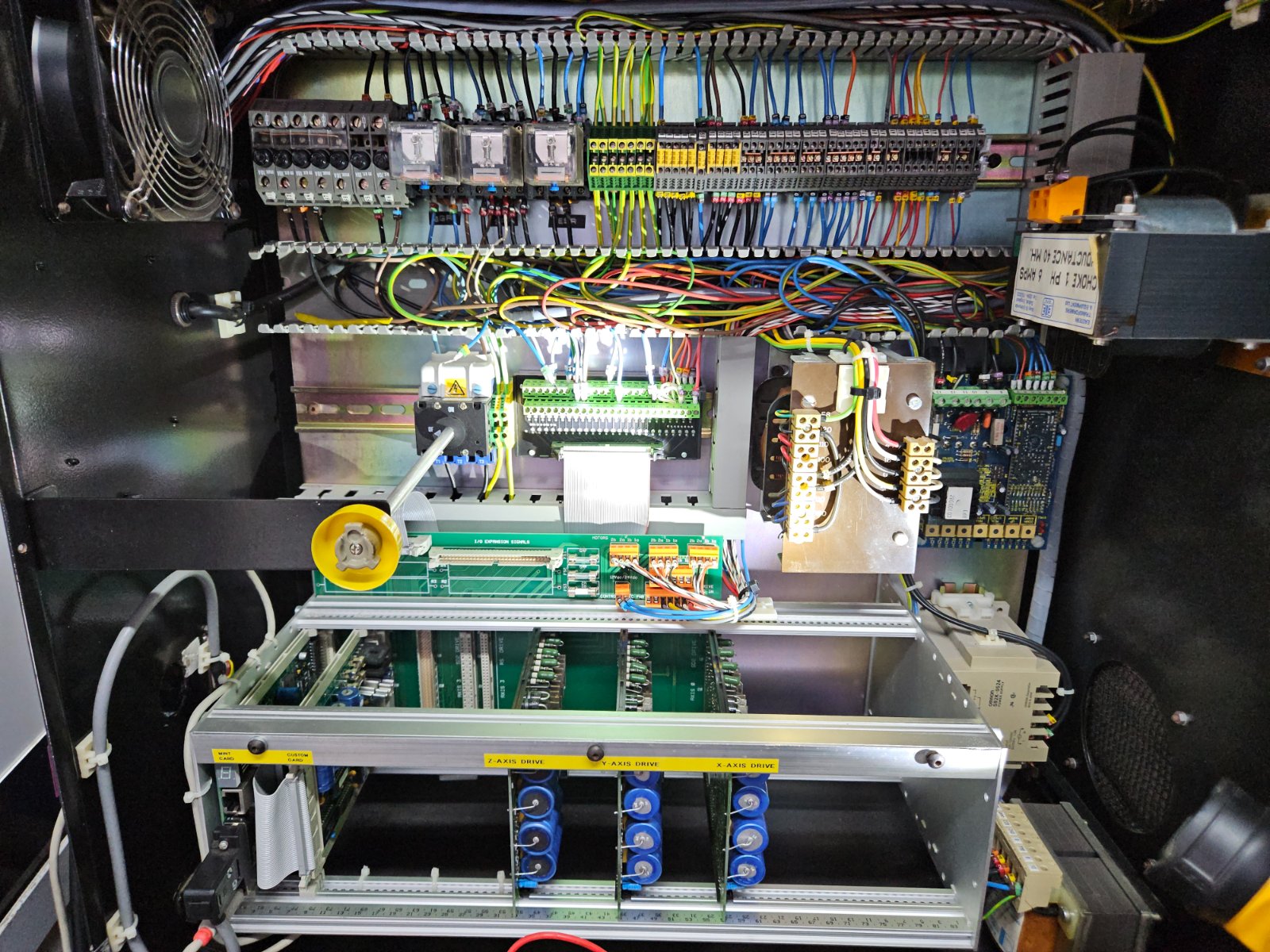

Spent a short amount of time, doing some more investigation tonight…
When booting up mill and spindle ramps up, SGR is NOT energised.
With SGR removed, spindle still goes rogue and ramps up on its own!
Removed #54 & #55 from green bar at lower end…
With spindle stopped, 180mV across terminals.
176mV @ 1000rpm
182mV @ 2000rpm
185mV @ 3000rpm
185mV @ 4000rpm
Haven’t got a 10k pot yet for other tests, but will do so soon.
There is an intervening Baldor board.
I’m waiting for Sprint to come back with some more info/prices…
I happy to go with either the 1200 or 1220i… they aren’t ‘megabucks’, but if it’s the Baldor board, it could still be a waste of cash… so still trying to prove what’s what.

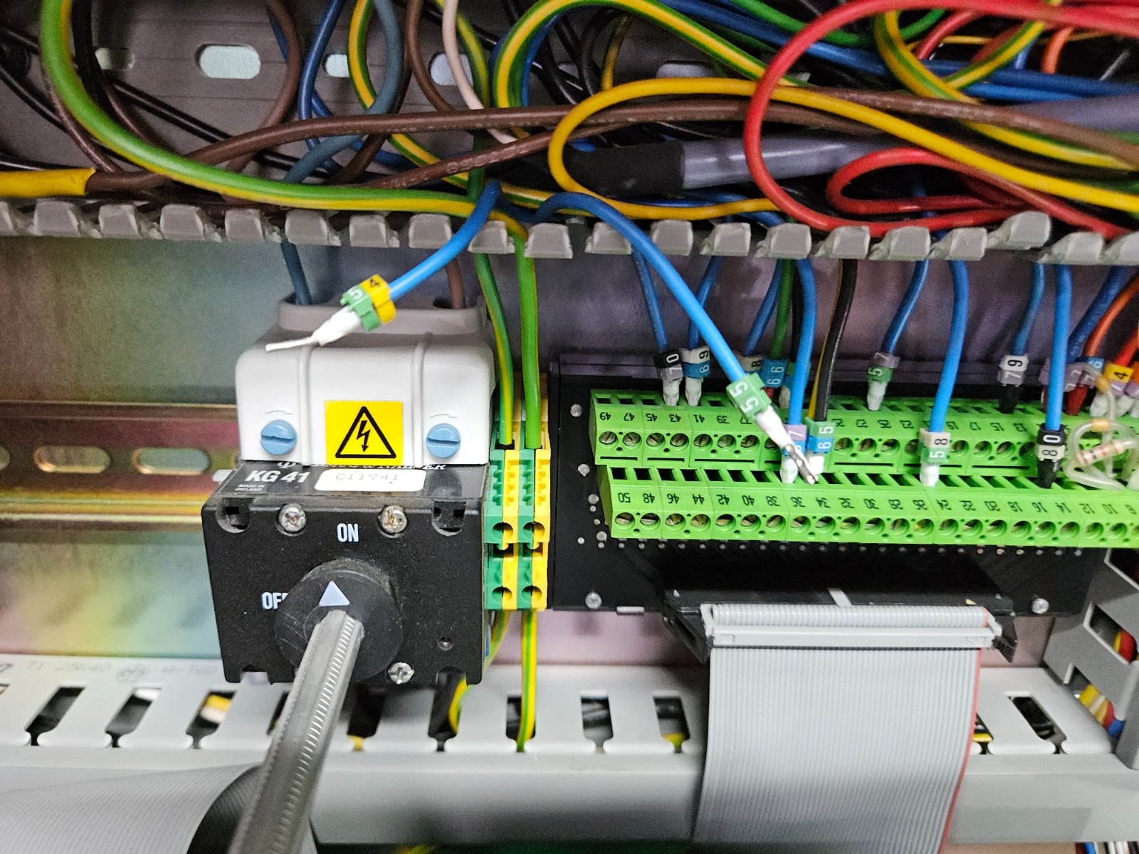

You can easily test the Sprint drive by disconnecting the 54/55 input wires and using a battery of say 1.5 volts to put a put a safe voltage to the Sprint input you should get around 600rpm, if that works then the Sprint is probably good.
I am a bit puzzled what the two Blue wires at the top of the drive in your photo, I have never seen any wires connected like that on any Sprint drive on any machine, suggest you ask Denford what they are for.
Buying one of the new type Sprint 1220/1220i will never be a waste of money IMHO.
Re: Triac Spindle (Issues)
Lone_Ranger wrote: ↑Mon 04 Oct , 2021 23:03 pm I am a bit puzzled what the two Blue wires at the top of the drive in your photo, I have never seen any wires connected like that on any Sprint drive on any machine, suggest you ask Denford what they are for.
They're connected to the stall detection output from the Sprint drive.

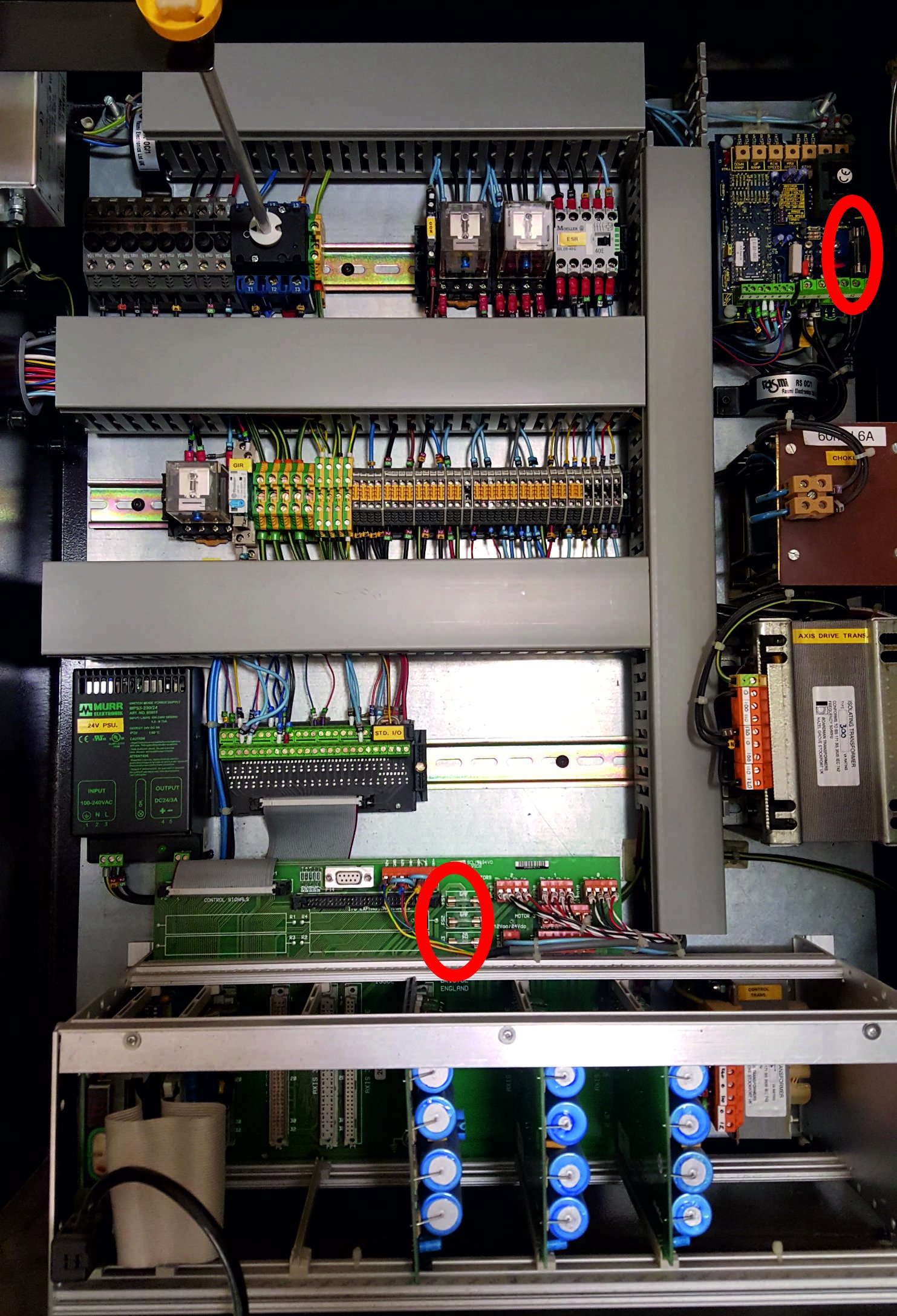

I am also having issues with the spindle not running after a recent crash. These fuses are ok are they any others I've missed?
You need to unscrew the caps

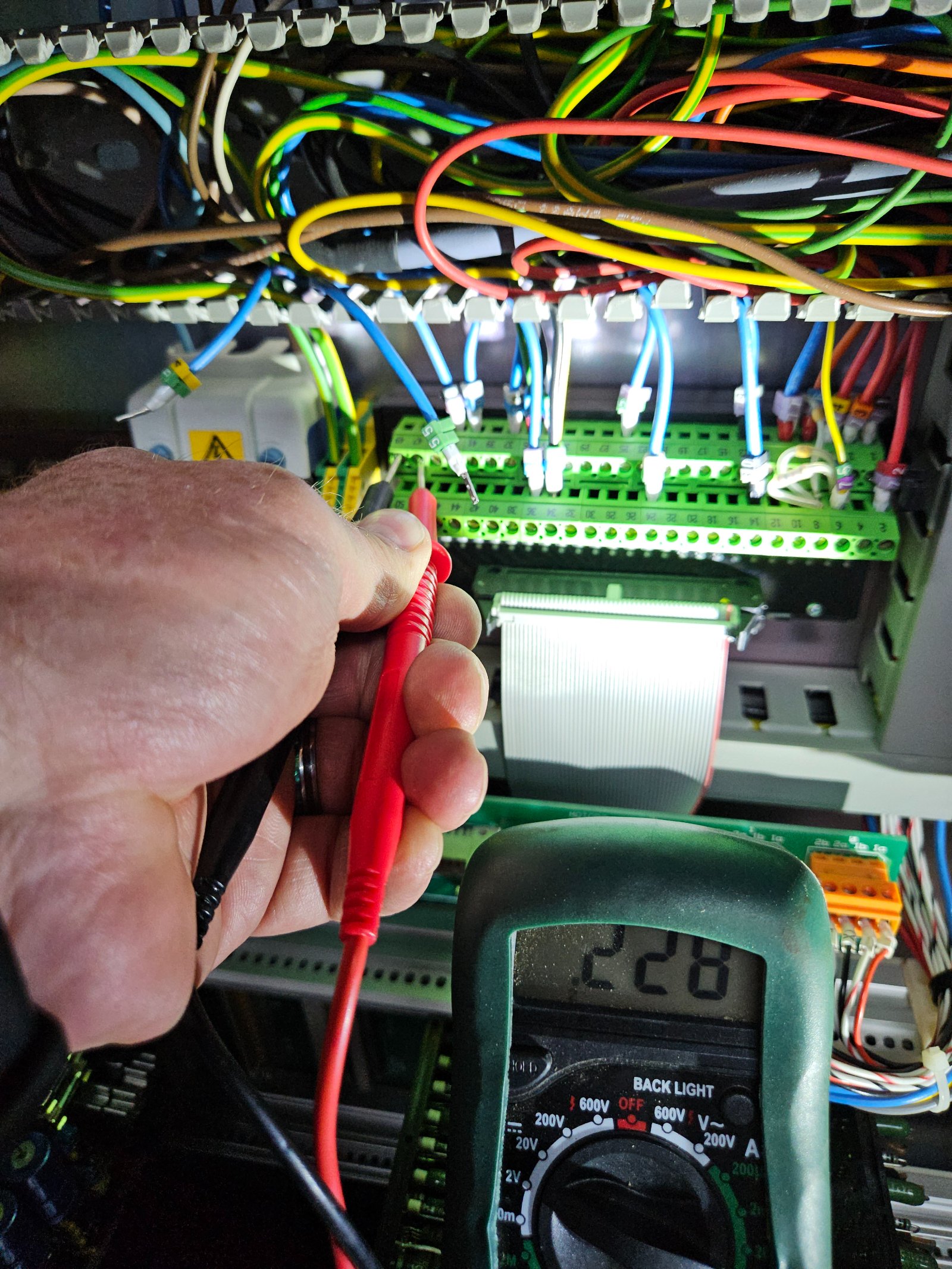

Hi everyone
I have also been having trouble with my spindle.
Bought the machine second hand and untested!
When first connected using VR Milling 5 the only thing that would work was the spindle, having cleaned all the MS and home switches X, Y & Z now all home and jog perfectly via the control panel.
When manually starting the spindle though the relays activate now but the spindle does not.
I've checked all the identified fuses which are fine.
The power light comes on the spindle board.
The wires numbered 54 & 55 which are in locations 47 & 49 have .228v across them when powered on. When VRm 5 connected to machine this goes up to .863v but does not change when spindle control activated on control panel.......
Is there any other checks to do to prove what is at fault.

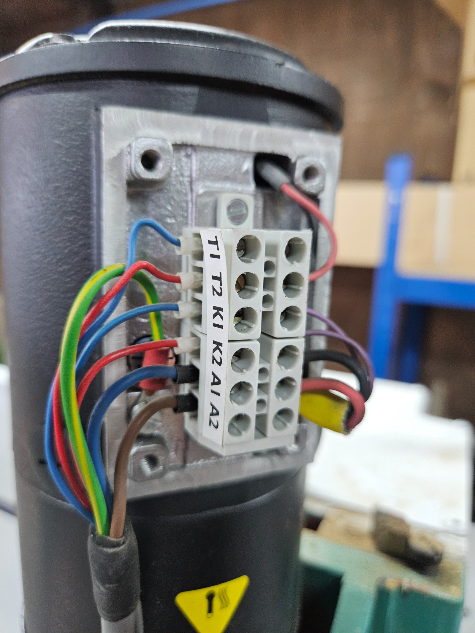

Is there a way to manually test the motor?
Thanks for any help.
I presume you tried to increase the analoge voltage (spindle speed)?
I would remoce the retaing bar from the front of the rack & pull out both the controller card & custom card slightly. Then push them back in & try again.
