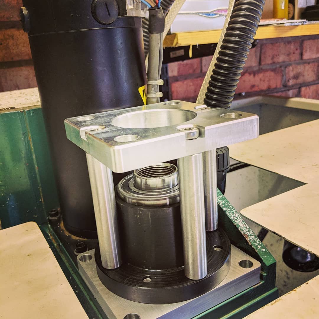

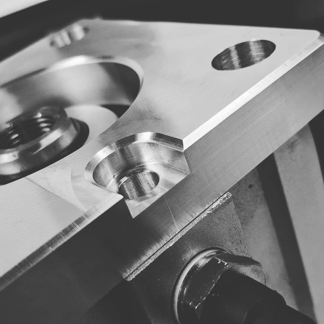

I've made some progress with the drawbar.
Have a look at my Instagram: https://www.instagram.com/p/BkqLAEPgCw7 ... y61gt7u43m

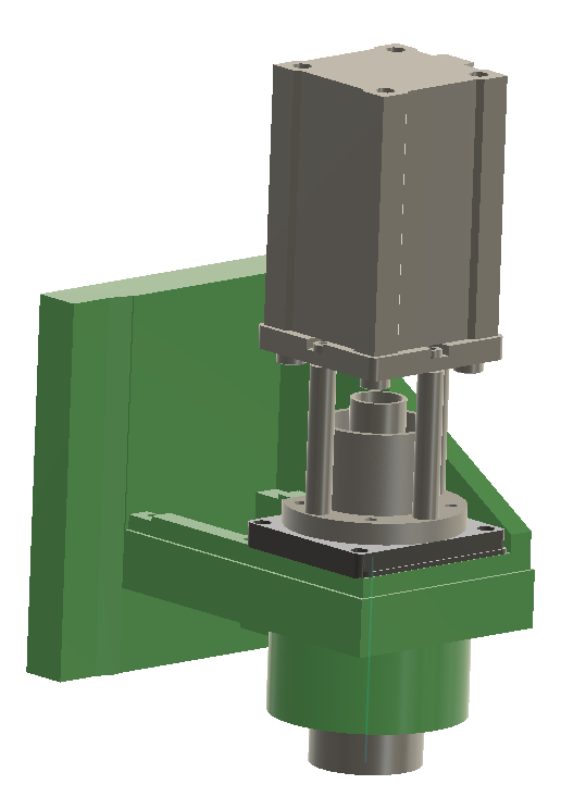

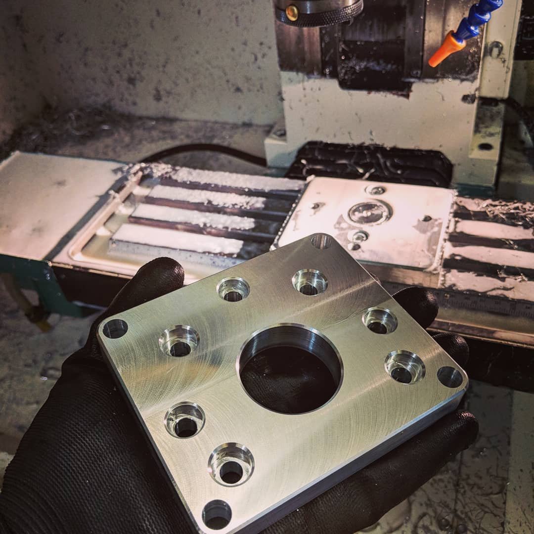

I have been using the power drawbar without issues.
I am sharing the fusion 360 model here in the hope someone finds it useful.
Please find the 3D model for the drawbar assembly attached.
Model Image:
Some photos of it being made:
