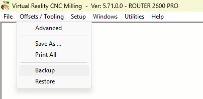

The only files you will need to copy across are the Offsets/Tools. Open the Offsets/Tools and a new menu will appear on the top bar called Offsets / Tooling. Click this and Click backup, once you click ok to the first backup it will give an option to Backup file to another drive, click Yes and select a USB stick. these can now be restored on your new computer by clicking the Restore button and click on the USB stick picture.
Screenshot 2025-01-13 122939.png (10.78 KiB) Viewed 9209 times
