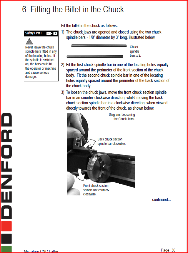

The machine is supplied with 2x Tommy bars. these fit into the holes in the chuck to loosen the jaws.
Re: Micro Turn Pro
On the software install menu there is an option to veiw or download the manual for the machine
