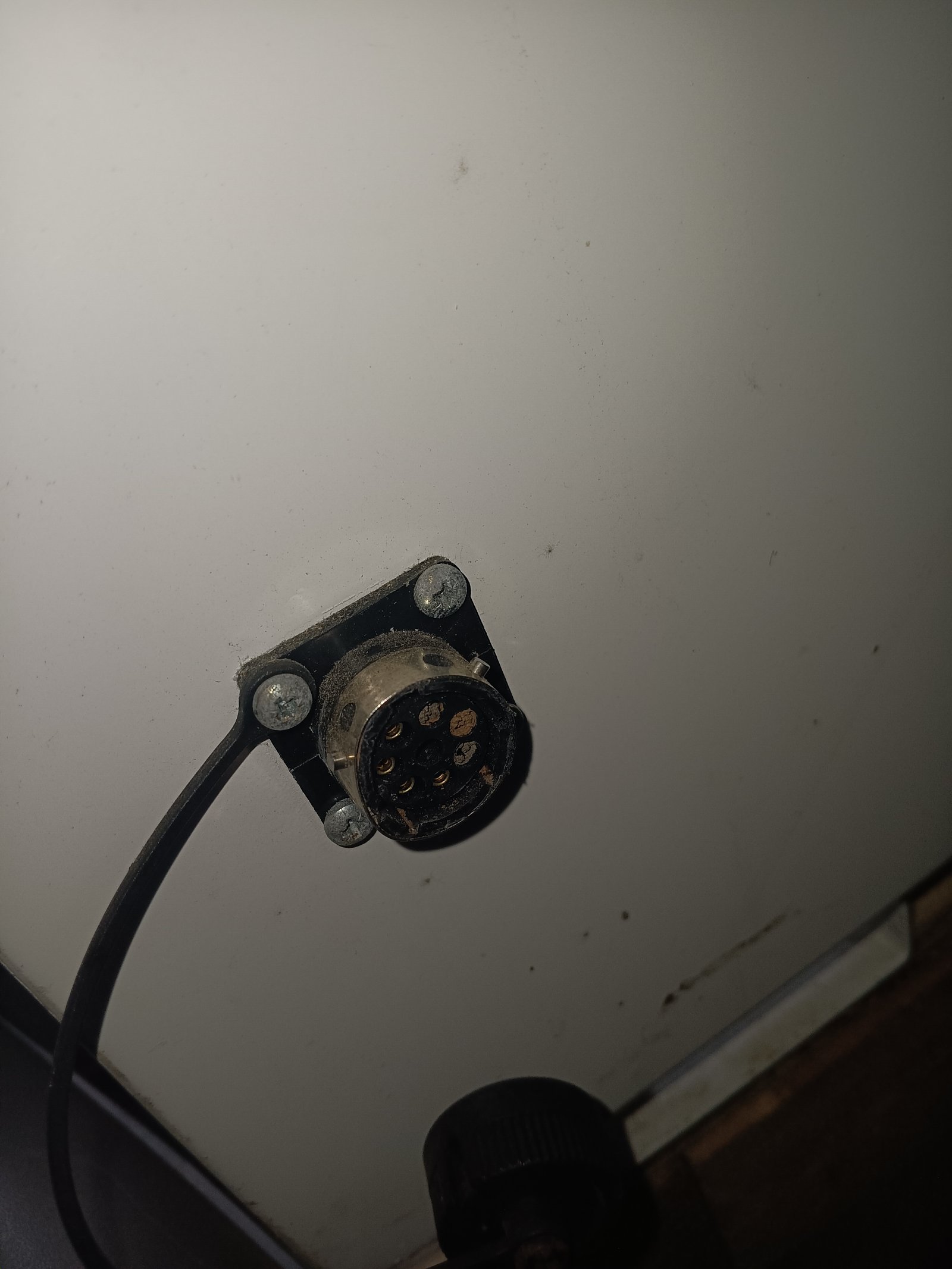

Round 7 pin port
Looking for details on what this round 7 pin port on the left rear side of my scantek 2000 mill is an what it can do?
Re: Round 7 pin port
Hi It is a Robot port.
If the machine is being supplied to the USA a QM plug will be fitted.
Test Procedure for Robot Port:
1. Fit link between A and B on the QM plug
2. Run the QM test program “QM TEST”
3. When the M62 is active Measure on Ohms across C and D for continuity. Check also that LED2 and RL3 are operated.
4. Once M64 is active the circuit should be broken and RL3 and LED 2 deactivate.
5. Check the test program cycles round until you remove the link between A and B. Once the M66 is active after 10 seconds the program will stop as the M code times out.
I am switching to linux cnc, I might turn it into a 4th axis
