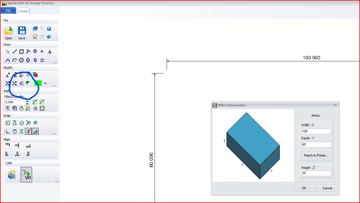

Re: Is it possible to trim lines?
The trim feature is now standard in V2 of QuickCAM.
You still have to explode objects to be able to trim them.
