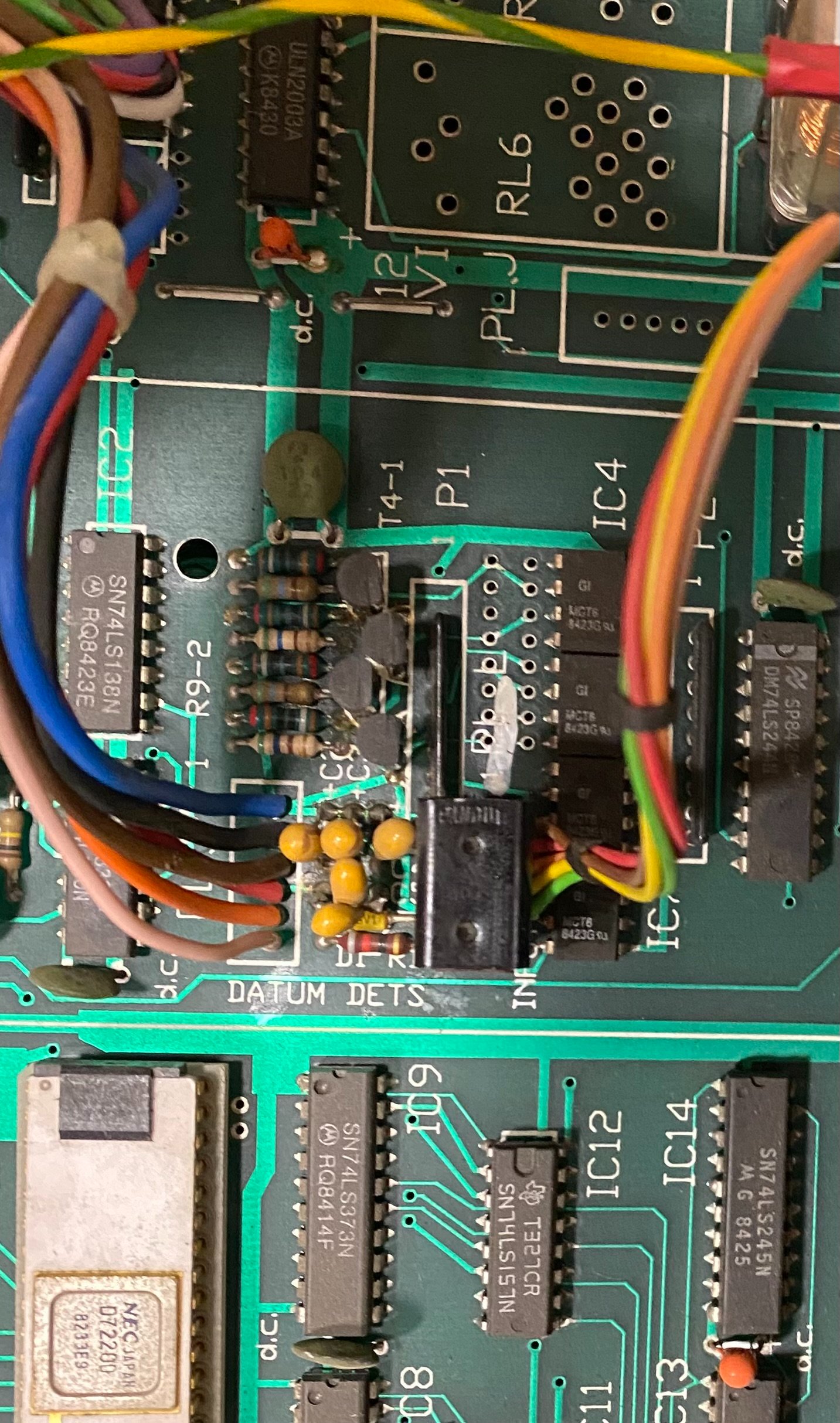

It's a long ago but I serviced was sent to service one & was told to cut the resistors on the board. Not sure which they were but it worked.
Re: Triac PNC3 Datum
Hi Martin,
On the Datum section?
Anything look familiar ?
I could cut legs and see if I get lucky ..can always solder them back if needed ,
