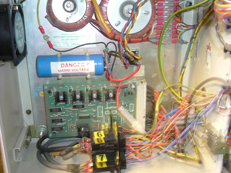

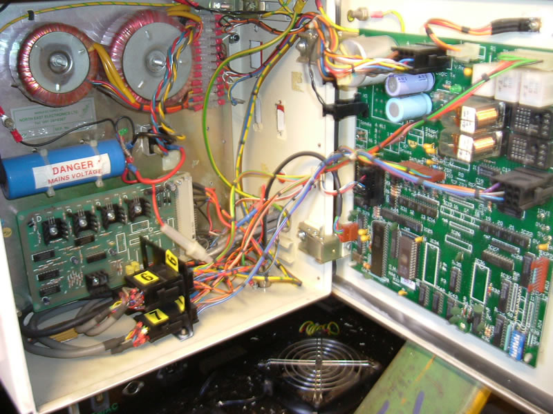

A photo of the inside of the electrical box would also help us be sure what we are looking at.
ok, here a few pics of the inside of the rear cabinets. The left-hand one(viewed from the rear) is full of electrnics whilst the right-hand one is mainly pneumatics.
The left hand one does look to have had a bit of a refit at sometime with evidence of old cabinet holes being covered up and redrilled. The factory records indicate it did come back to Brighouse during 1991 for a refit (?) so this might explain that one.
I will also take a pic of the short lead if anyone needs to look at that, but being only around 12" long it is too short to feed the monitor.
You will also see from the pics the two sockets on the underside of the left hand box.
Thanks ...Richard

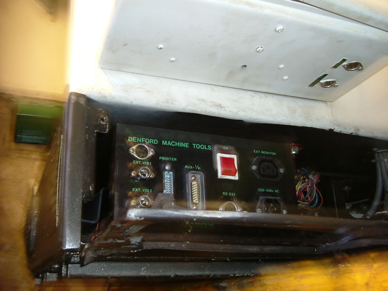

...please also note the multi-pin socket on the machines rear panel, not cabinet, just below the word Denford and above the Ext video sockets, that doesn't have a legend??? Very strange
Ahhh - the pics bring back memories !!!
And if my memory serves me right then...
  • The RS232 connector on the top box should connect to the unmarked socket above the vidoe connector on the back of the machine
  • The Toolchanger connector on the top box should connect to the 15 pin Aux I/O connector on the back of the machine

...well you will either be right or I will have a toasted machine :?
What you suggest is the only place the short cable can go to, but I needed to get some advice first. I'll bob down stairs now and give it a go.

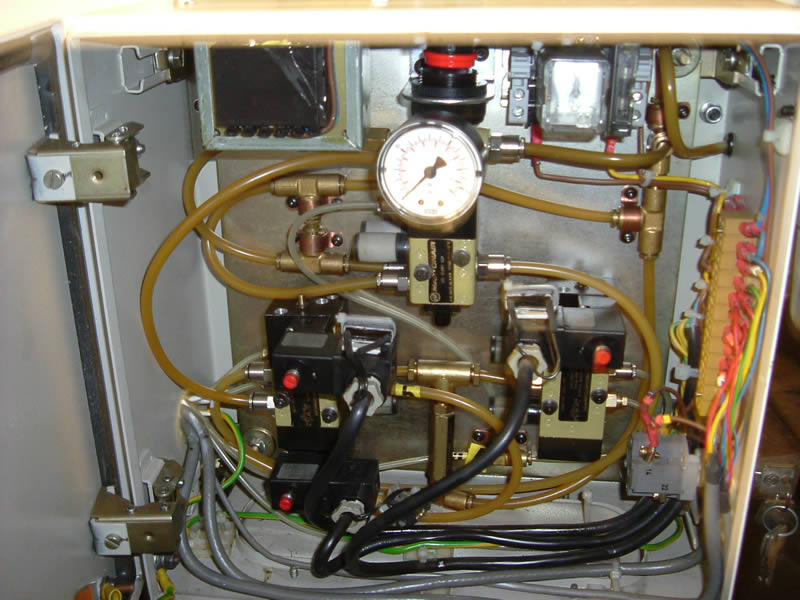

Yup, my Fanuc with ATC won't ref unless air is supplied and the toolchanger is up in postion
I don't think the Triac PNC3 controlled machines had an air pressure swich fitted, but Triac Whizz could be right about the ATC having to be in it's "safe" position (arm up and back). Worth trying to strap it up rather than buy a compressor
Already tried taping the tool changer arm in the uppermost position but still didn't run. Anyway, I am borrowing a smallish compressor tonight so should find out one way or the other.
...Richard
Borrowed a compressor and got it plumbed in last night. Upon applying air the toolchanger magazine moved back and up into its park position as would be expected, but when I applied power the same fault code came up on screen.
Can anyone supply a trouble-shooting guide or flow chart to help me out as I am now at a loss as my 'expertise' is purely mechanical.
I have noticed some small rectangular objects wired into the system and fixed with double-sided sticky pads to the tops of the solenoid valves. Some of these pads have come away over time and the 'things' are no longer attached. What are they and will refixing them make a difference?
Thannks ...Richard
p.s. any experts want to come round and have a look to help me sort the problem are always welcome. The machine is at my house in Birkenshaw, Bradford, which is around 2 miles from Brighouse :wink:
I think the black things are suppressors to soak up noise when the solenoid valves are switched (are there two wires off them - going into the solenoid plug top ?).
They would work without them connected anyway so thats not the problem.
Even though the air is on - pressure may not be high enough - can you find an air pressure switch, and see if its switching or try linking it out ?
PS - John Purcell has just come in to see us - looking tanned and relaxed :D
He says retirement is brilliant !
Try looking for micro switches - check wires & that they are making contact.. I guess the setup on the ATC is the same as a Fanuc one :?
