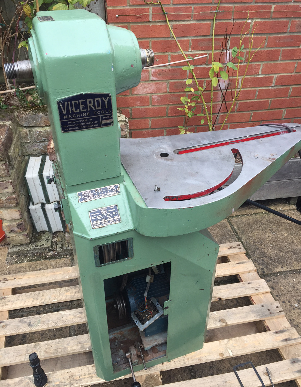

Here it is as it arrived on the pallet:

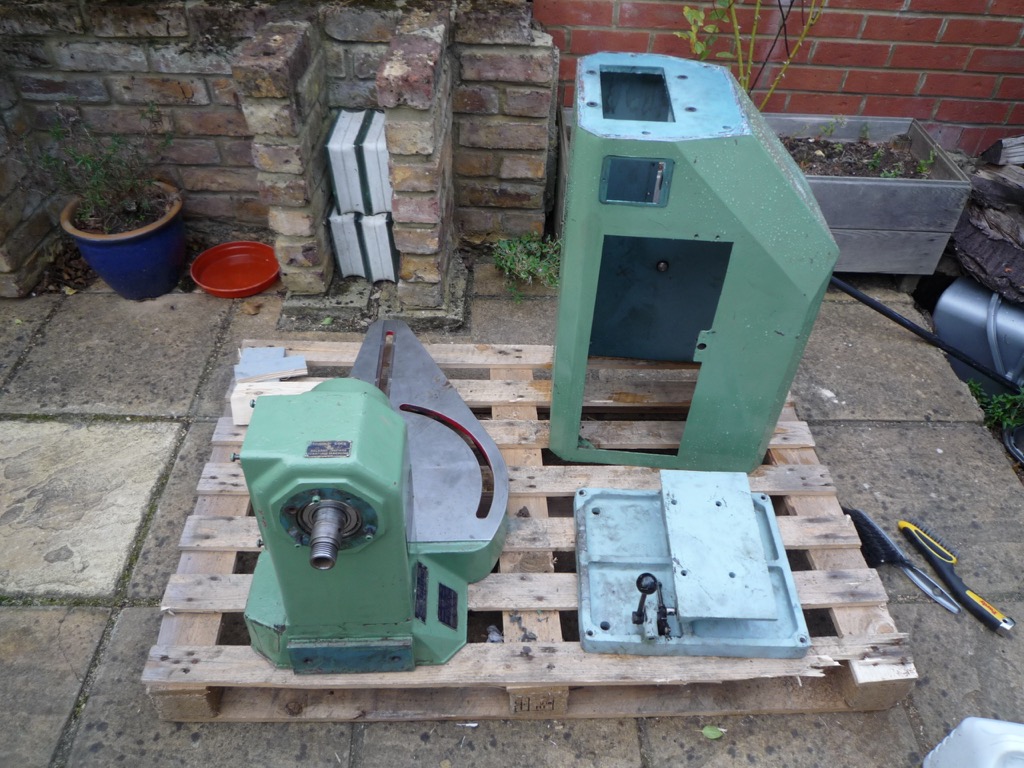

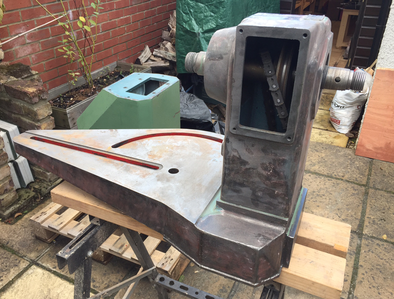

And then stripped down into the main components: headstock and base, steel base and cast iron plate for the motor:

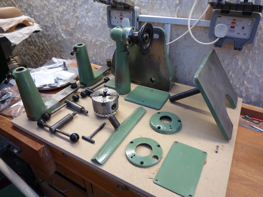

All the other components laid out on my workbench:

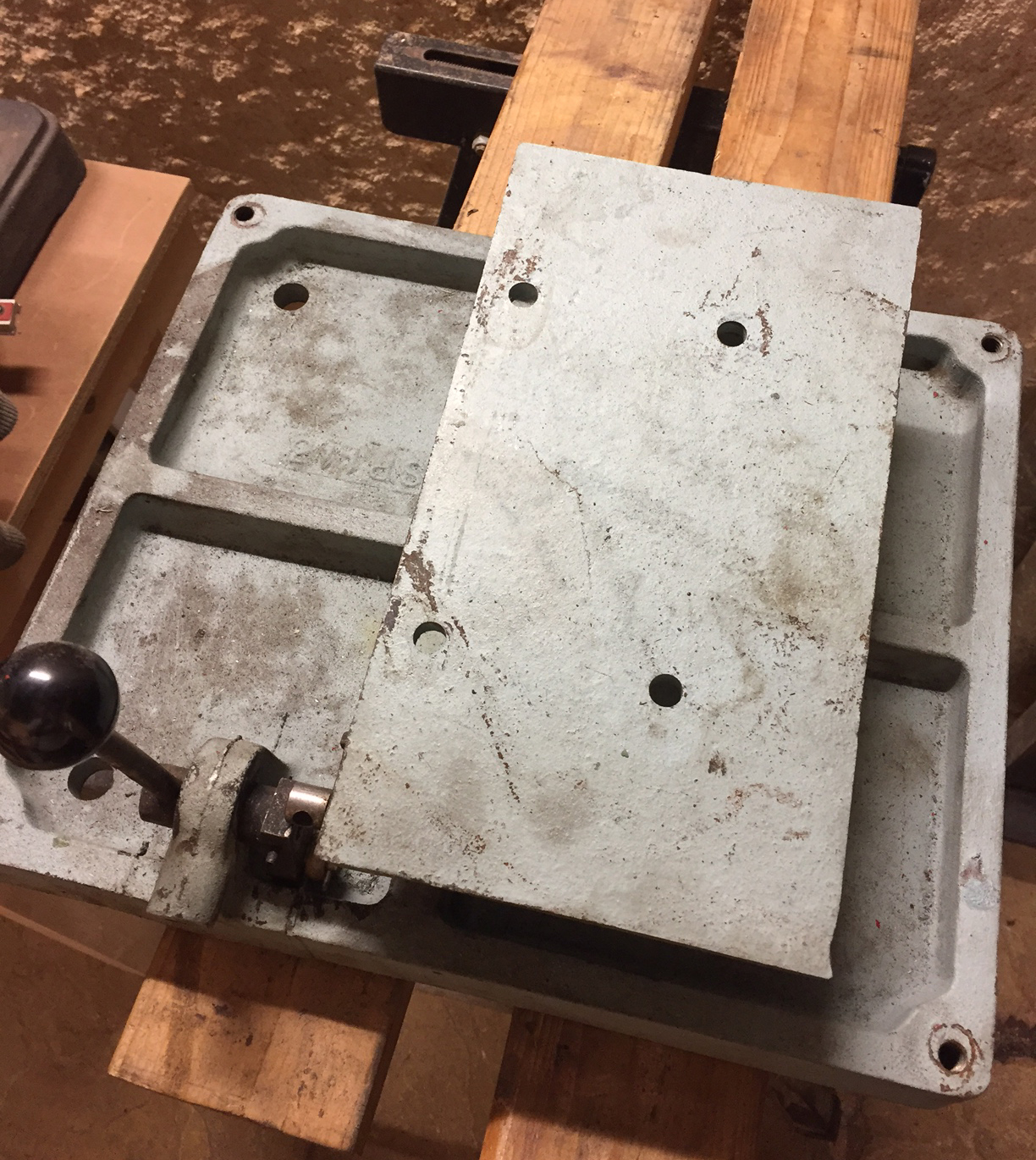

After a couple of hours with a grinder with a wire brush attachment, which really ripped through the paint right back to the cast iron with a little pressure:
I used a "Surface Preparation Wheel" from Screwfix on the tool rest uprights and tailstock - and that whipped through the paint with very little pressure at all. This was a great tool for stripping paint off, but be careful not to apply any pressure at all!

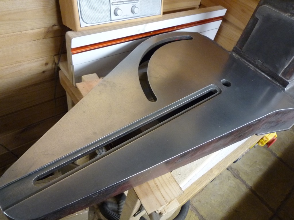

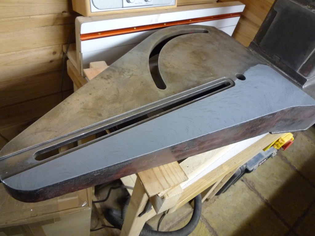

I also turned my attention to the lathe bed to remove some of the rust and marks. I used a variety of metal polishes: Autosol Bluing Remover which is designed to remove the blue heat stains from the exhausts on my motorbike, applied with 000 wire wool:
The lathe bed came up reasonably well with the Bluing Remover, but I also used Autosol metal polish, and even tried a Brillo pad with WD40 to remove some of the deep stains - however, the circular stains wouldn't clear entirely:

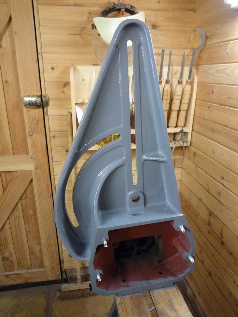

The underside of the lathe bed after 2 coats of primer:

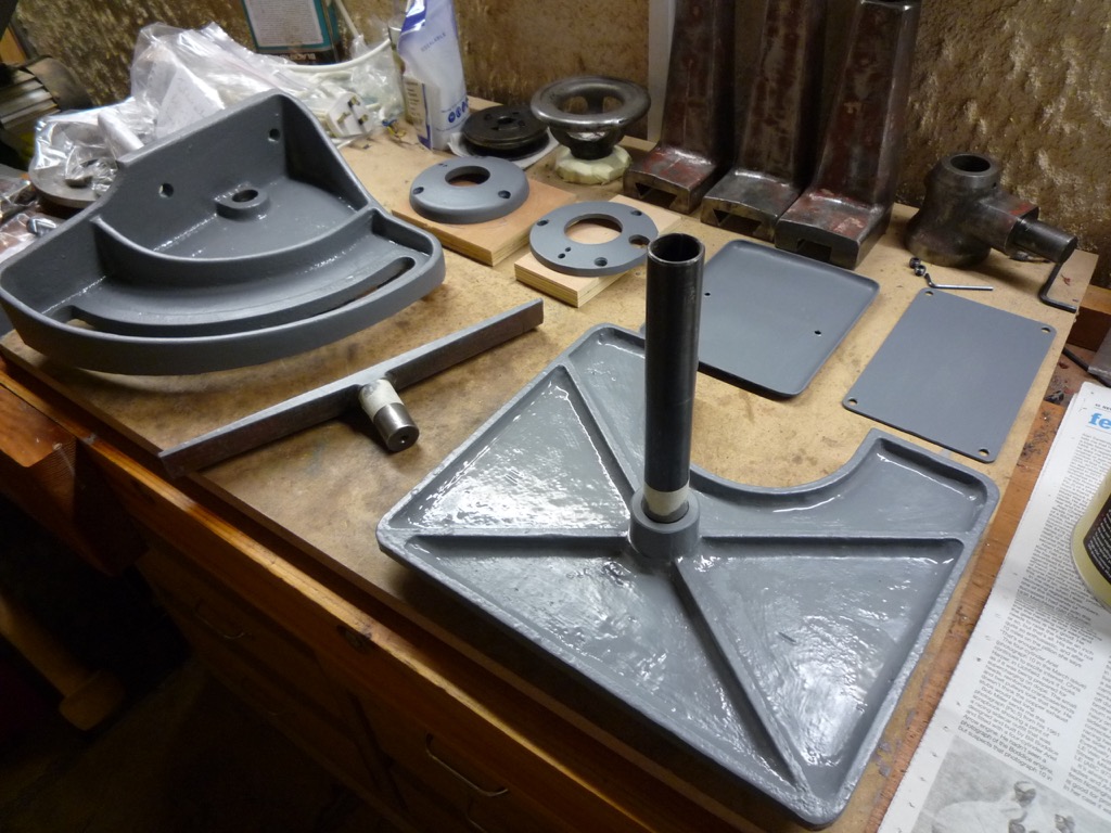

And the other components being primered:
I'm now waiting for the primer to dry completely before I can start on the top coat. Pictures of that to follow when complete.

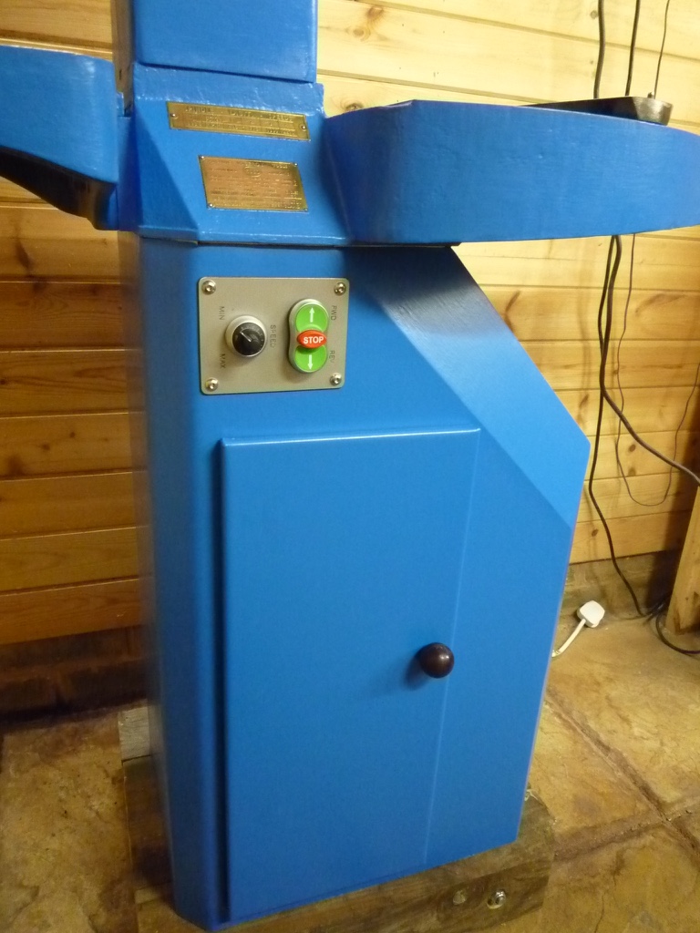

I've now completed the repaint and rebuild of the lathe, as shown below.

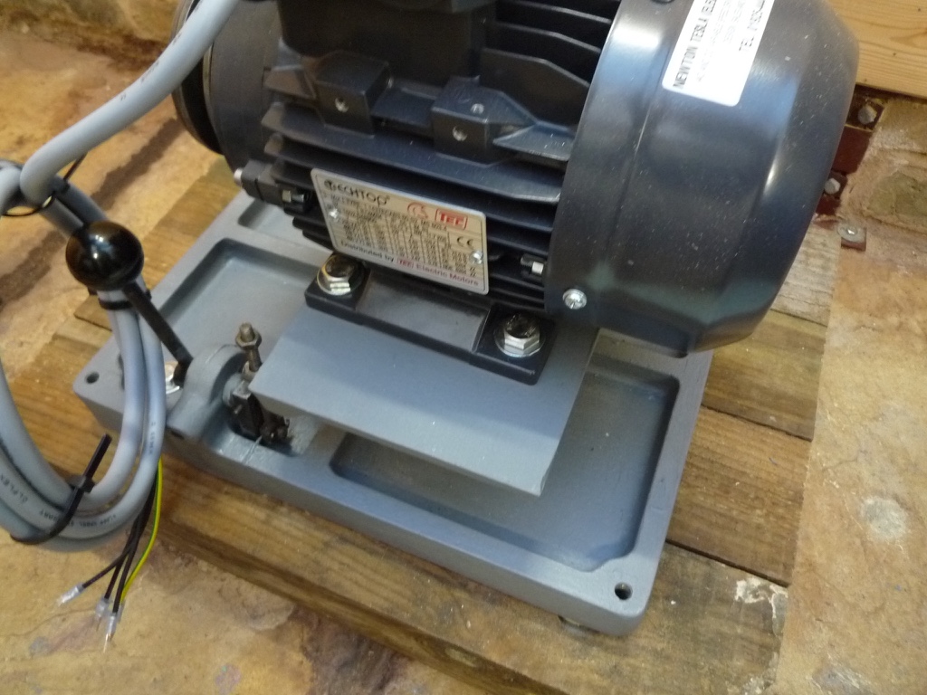

First of all I had to bolt the new motor to the base plate:

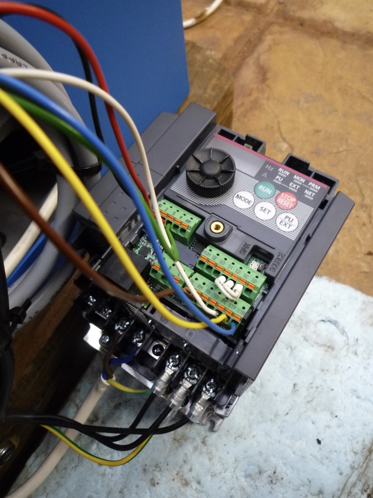

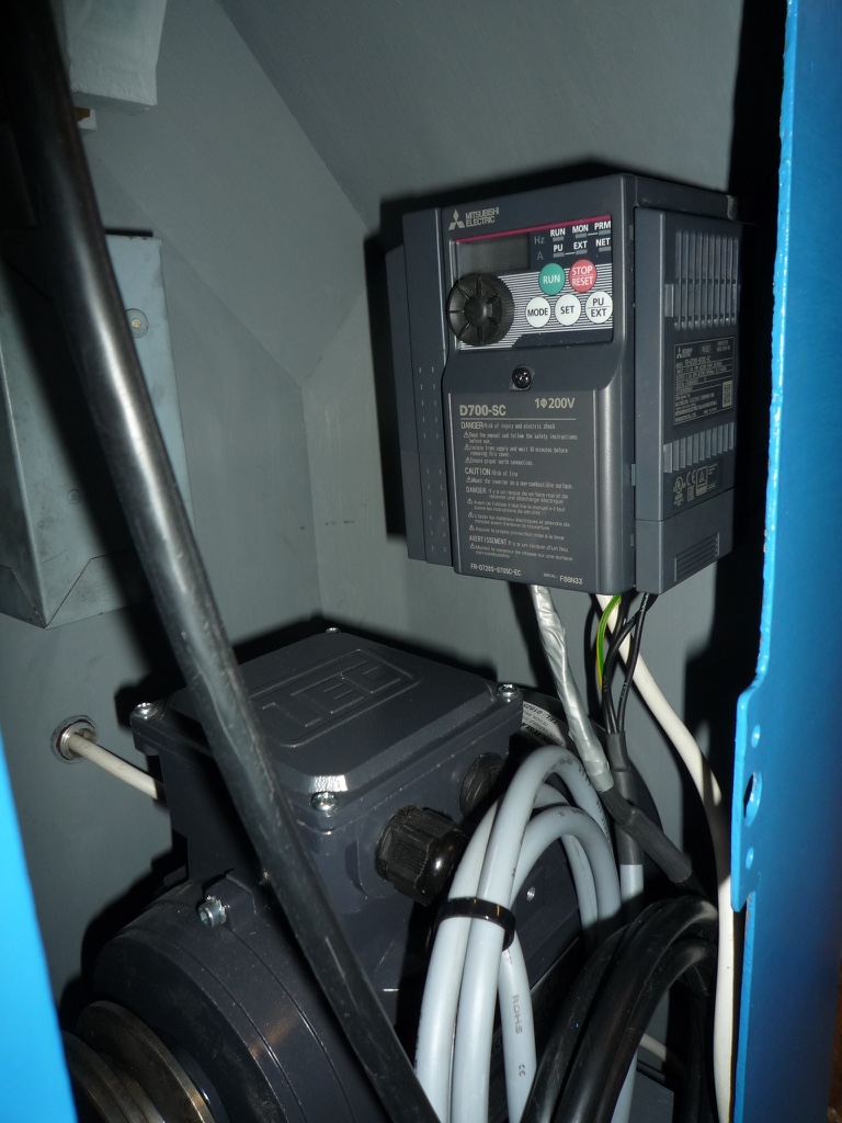

Then I connected all the wires to the inverter: the mains lead from the plug, the grey cable from the motor and the black cable with the wires from the control panel. Instructions from Newton Tesla were extremely clear and simple, very easy to follow.

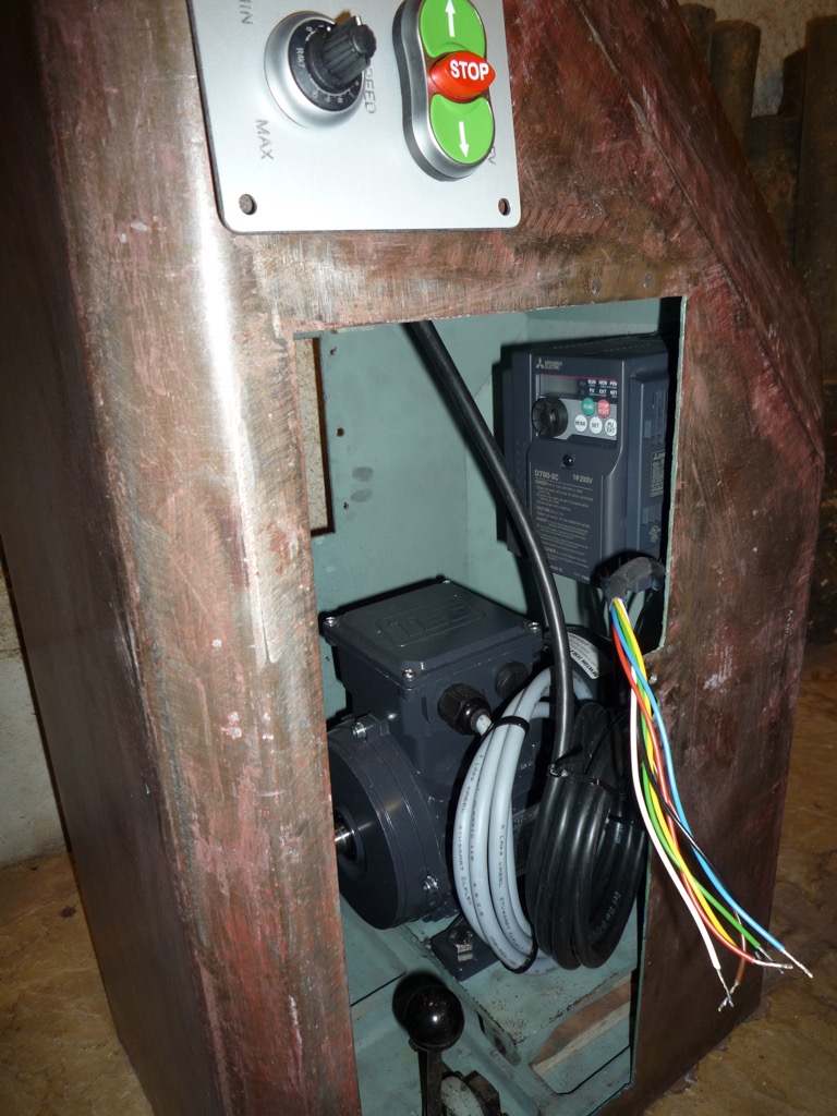

Here is the inverter installed inside the base case, with four socket head screws from the outside to nylon locking nuts on the inside.
The control panel and door now fitted.

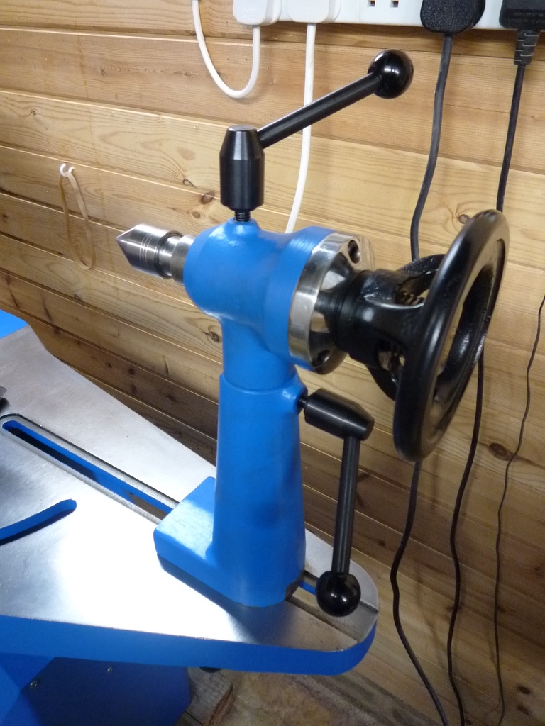

The tailstock fitted to the bed, with the original handwheel repainted, and new locking handles for the tailstock and live centre or chuck from Berger tools.
The tool rest fitted to the bed and the chuck to the spindle.

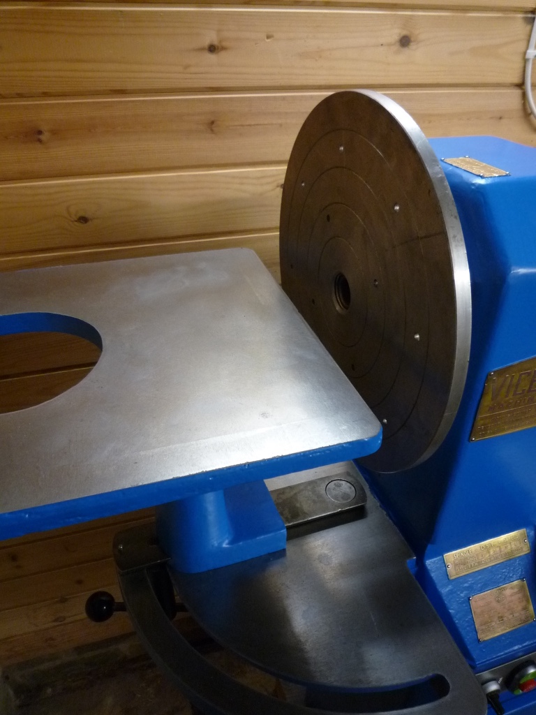

The left-hand bed installed, with the sanding table and faceplate on the LH spindle. I have a sanding disc I need to screw to the faceplate.
And the finished item with everything complete.
I was concerned when I was painting it that the colour was possibly actually too bright, but once it's all together, it looks just how I wanted it to - and it'll soon be covered in sawdust and wood shavings anyway. I'm going to leave it for a week to let the paint harden before I turn anything on it. In the meantime, I need to make a spindle lock to fit onto the shoulder head screw behind the LH faceplate, and also start cutting and gluing some segmented pieces to start turning some more bowls.
I thoroughly enjoyed doing it, and, considering I've never done anything like this before, I am very happy with the result. Final cost of the lathe, motor, inverter, paint, handles, less what I got for selling my old lathe, was just over £1000 - but I now have a lathe with a 1.5hp motor and a 18" capacity (maybe even 19"), as well as a separate sanding table which I can use without having to swap chucks or faceplates. As I mentioned earlier, to buy a new lathe of this power and capacity would have cost me somewhere in the region of £2500-£3000 if I'd gone for a Killinger or Wivamac lathe.
Thanks for watching, and hope it is of use to anyone thinking about restoring or upgrading one of these lathes.
