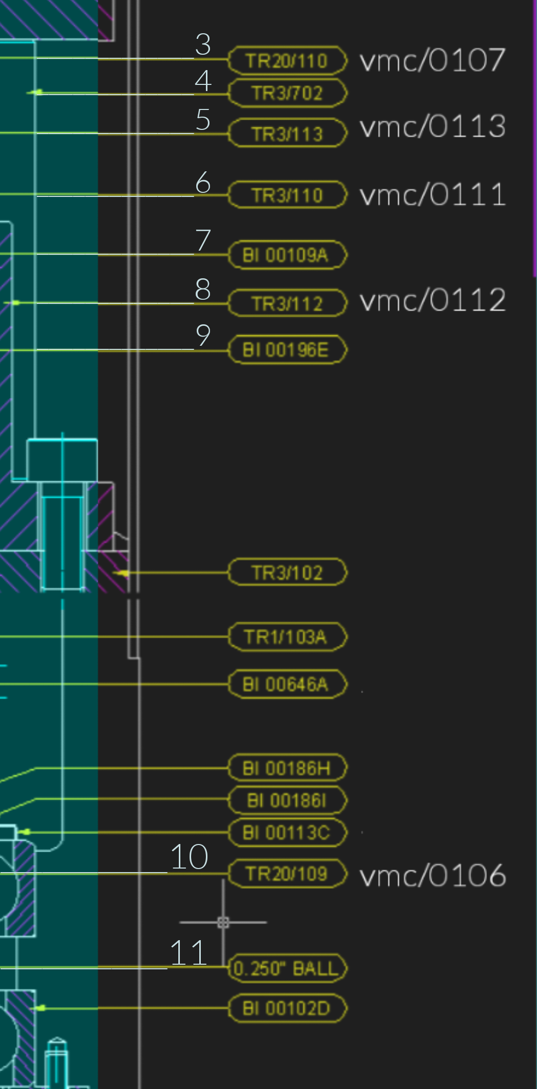

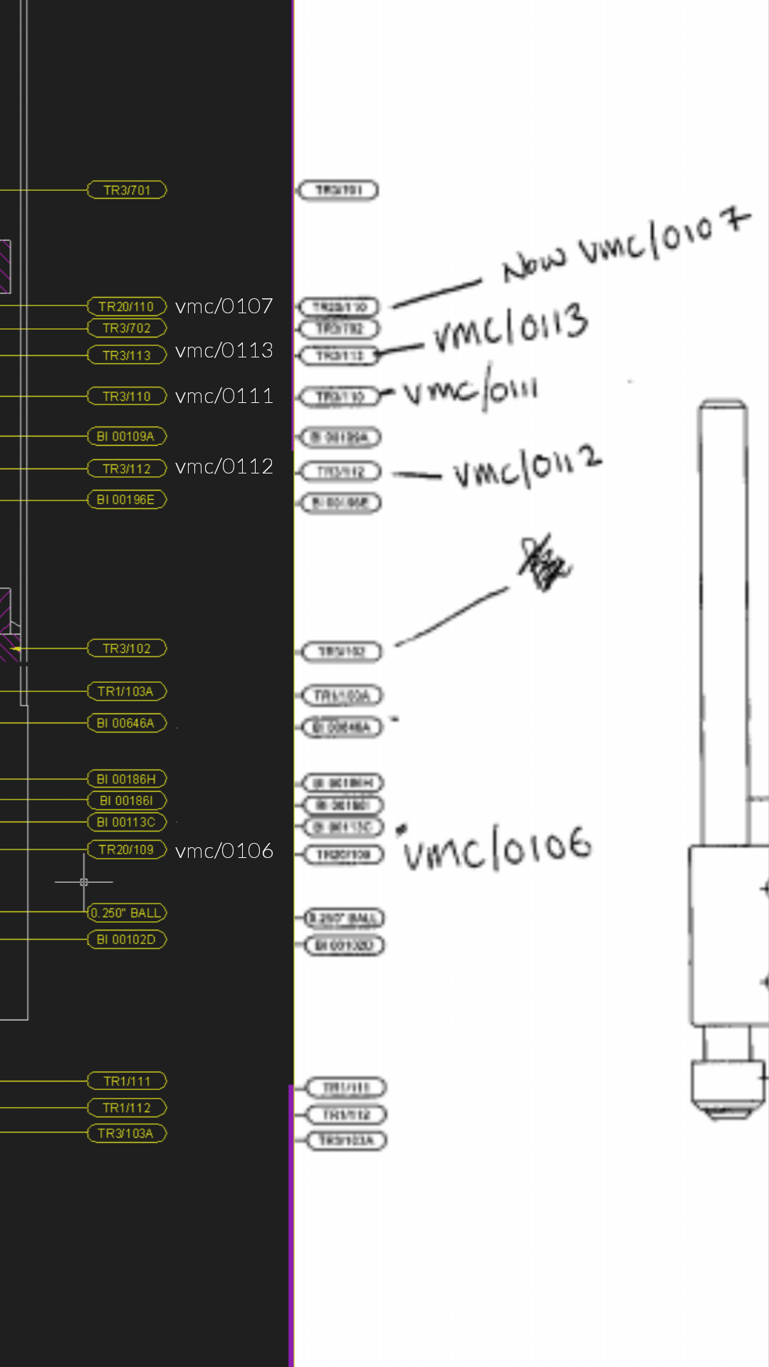

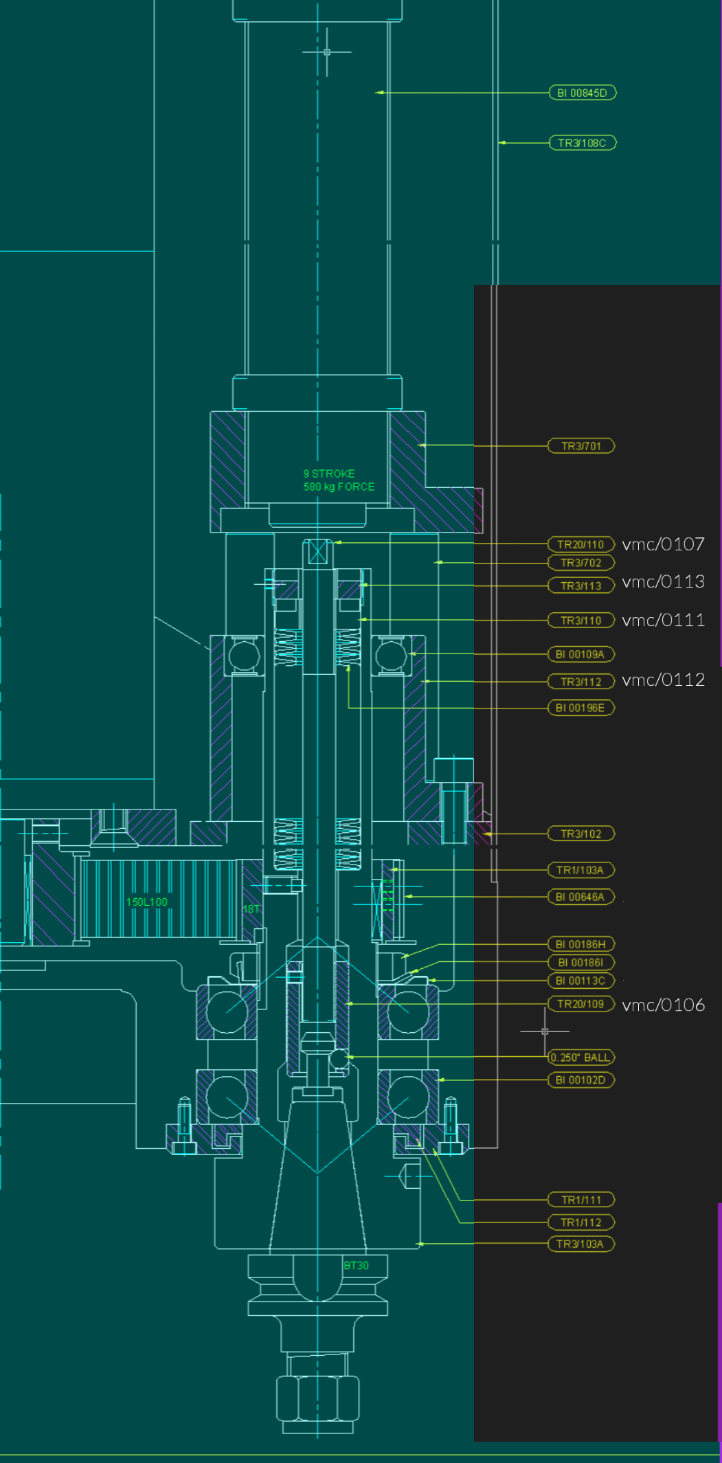

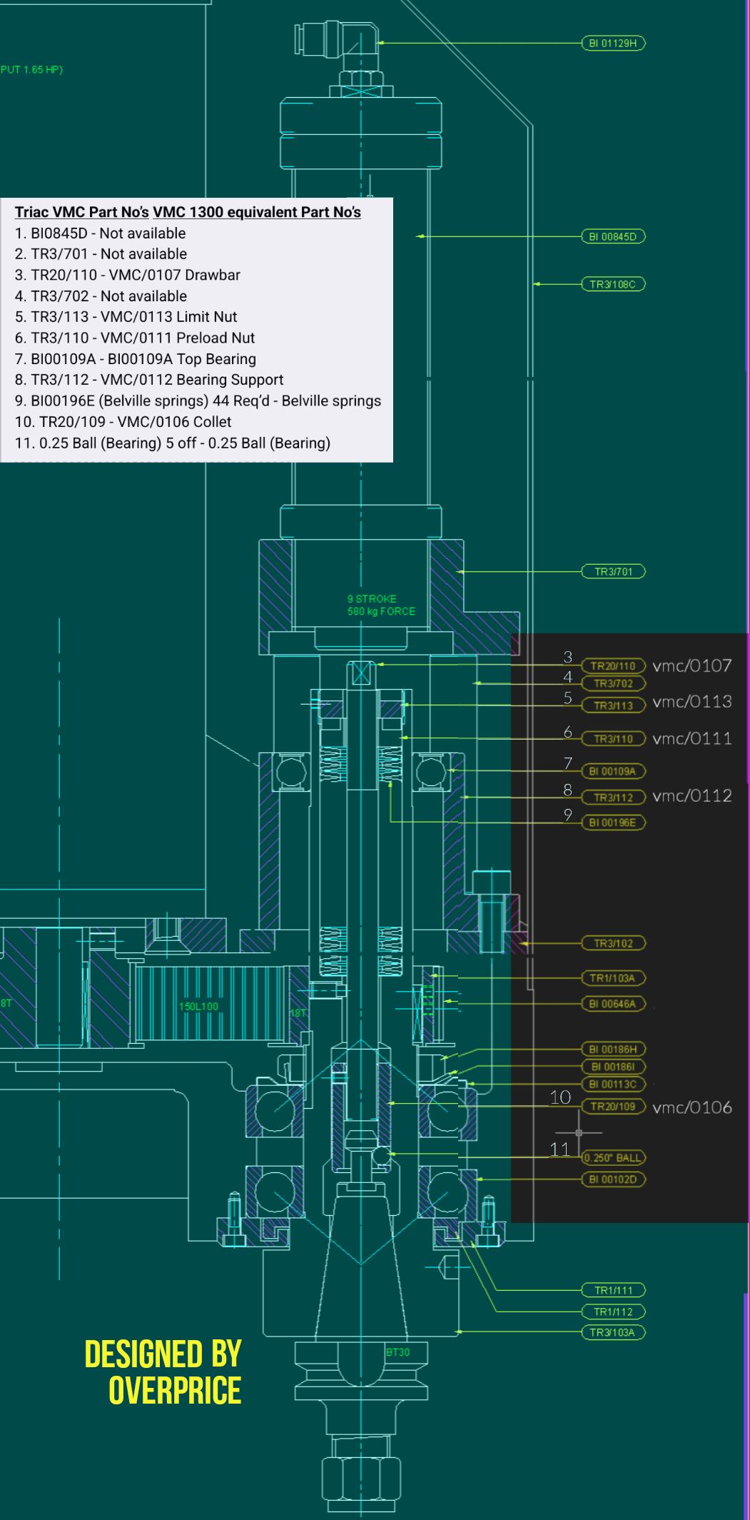

Triac VMC Part No’s VMC 1300 equivalent Part No’s
1. BI0845D - Not available
2. TR3/701 - Not available
3. TR20/110 - VMC/0107 Drawbar
4. TR3/702 - Not available
5. TR3/113 - VMC/0113 Limit Nut
6. TR3/110 - VMC/0111 Preload Nut
7. BI00109A - BI00109A Top Bearing
8. TR3/112 - VMC/0112 Bearing Support
9. BI00196E (Belville springs) 44 Req’d - Belville springs
10. TR20/109 - VMC/0106 Collet
11. 0.25 Ball (Bearing) 5 off - 0.25 Ball (Bearing)

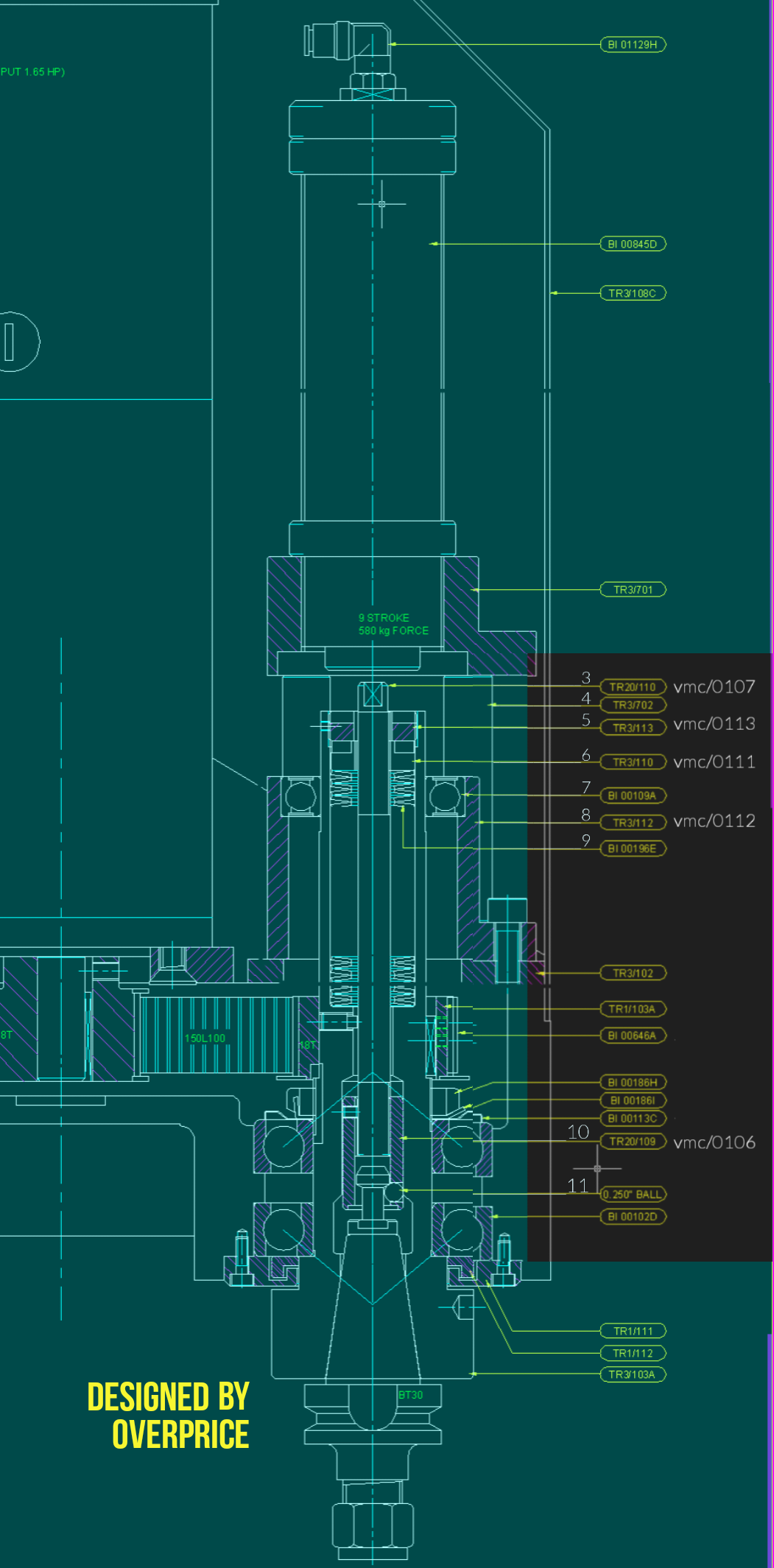

Re: TRIAC VMC - VMC 1300 Tool changer Part Nos
Updated
Final. Ready to order
