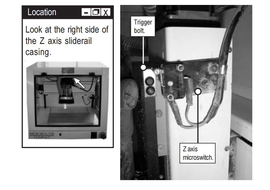

It is possible to lower the motor mounting plate so the tools can get down to the bed. You can see the screws to adjust this in the attached photo

I have the original manual and I saw the bolts. If I lowered it to the bottom bolt it only leaves it on 2 bolts and the trigger switch bar doesnt reach the trigger switch. I will just work on adding a thicker waste block to the table for now.

Not over familiar with the compact but on the microrouter the motor mount plate bolts to a unit which travels up and down on the z guides. This has the z axis trigger on it so that stays the same. You are just moving the mount up or down on that. Ill try to remember to take a pic tomorrow. It might be different on the compact.
