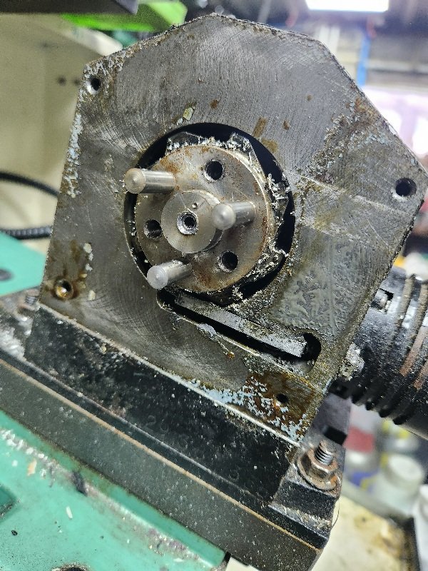

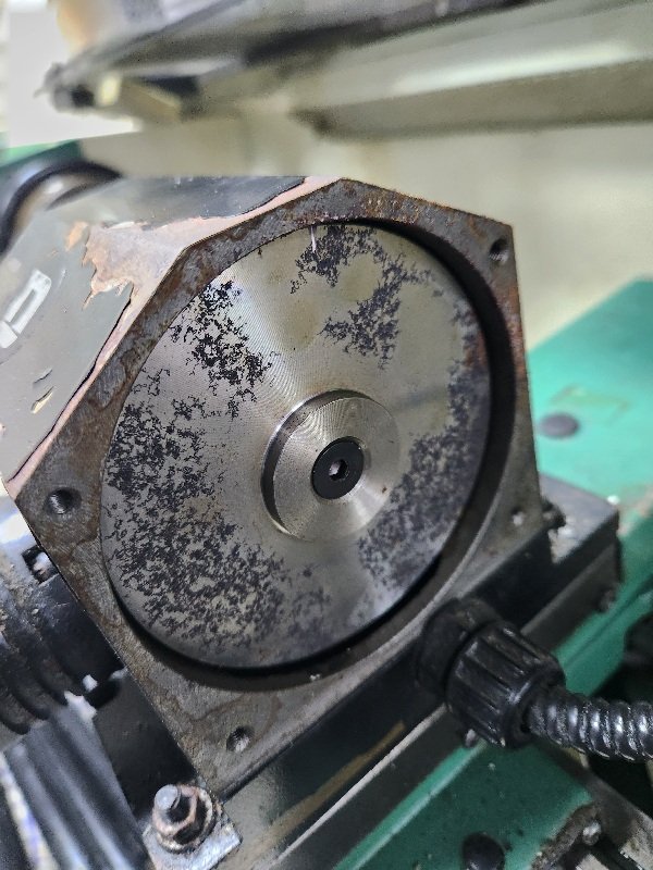

So next on my list is although i have some delrin rod to play with i want to clean and regrease the spindle and ATC as i doubt they have seen any fresh grease in at least a decade and any thats in is by now at best dried out and crusty.
While i wanted to test everything worked a thorough service makes sense before i start putting it to work.

Fairly sure mine is the older single type and there is a great stripdown guide on here.
Unless anything unusual comes from it i only plan on pulling the drive motor and tool holding block to gain access to clean and regrease.
I dont plan on a full stripdown but you know what they say about plans lasting past first contact....

Didnt go too far into the tool changer but enough to clean out the swarf and regrease it so it runs a lot better

oh and for reference the ATC teardown thread is this one :
viewtopic.php?t=5333
however I do have one slight correction. he says you don't need to remove the heatsink to remove the motor and gearbox..... you do
its held with 2 small grub screws in the solid band at 12 O'clock and 3 O'clock facing the ATC. if you look in the photo of it disassembled you can see the top grub screw and corresponding witness mark on the top of the motor. you need to remove the heatsink to get at the screws holding the motor.
he does say he cant remember doing it but it does need to come off.
