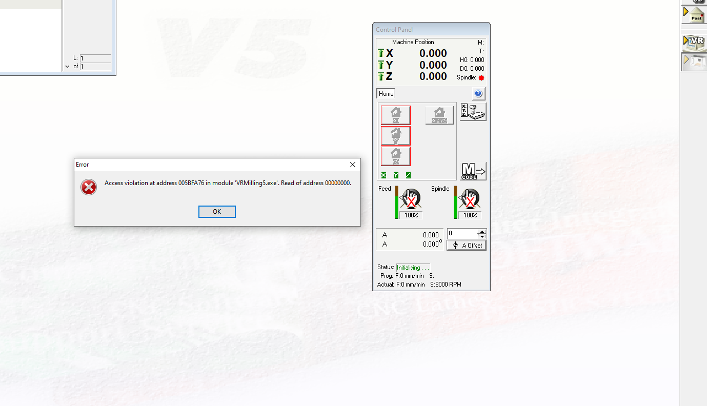

We have a Compact PRo 1000 and for some reason it is now having issues connecting to the PC. The machine was working fine a couple of weeks ago and when I went to use it last week I noticed the light inside no longer works and now I get the attached error message. Nothing has changed on the attached computer and no-one else has used the machine. The only thing I can think that has happened is a couple of students were mucking around with the building emergency power cut-off switch which would have killed power to the router while it was one?!? (but that just trips the circuit breaker to the room)

Don't worry - I've found a blown fuse on the 18v circuit. Off to get a replacement tonight and see if that solves the issue.

The 18V is rectified to produce the 24V DC logic which powers on the controller and the Light.
