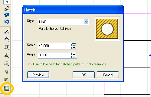

In this example, I have created a raster toolpath inside a D shape using the hatch tool. Because the hatches are created left to right, it will be possible to output a toolpath that follows the same direction.
(If you wanted it to run right to left, then you would simply mirror the hatch lines)

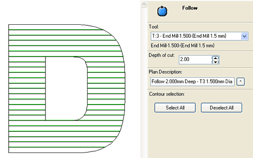

* IMPORTANT *<br />In the post output screen, make sure the sorted tool paths option is turned off before posting the CNC G code file.
* IMPORTANT *
Select the follow machining plan and choose the hatch lines previously created
Create hatch lines with the hatch tool. You will need to experiment with the scale value in order to get the distance between lines you require (ie tool stepover)

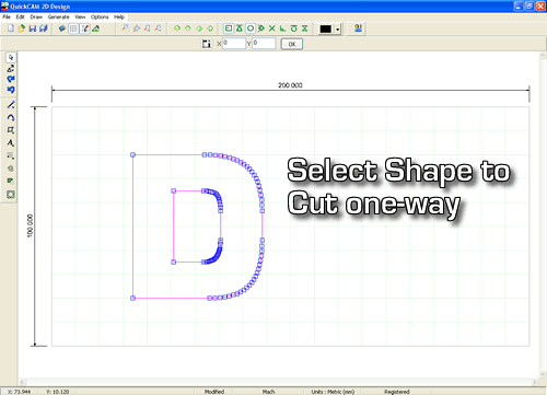

Select the shape you want to raster across in one direction
