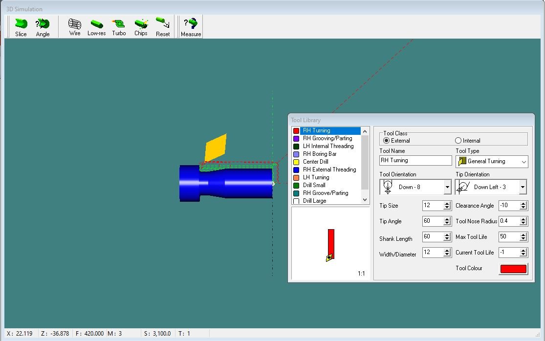

i am designing with quickturn2 and woring on a microturn pro. As you can see in the photo attached (photo link: https://prnt.sc/f0-G9nfaSAJM) , the program automaticaly cuts the upper half of my material. I need to make it cut from the bottom side, do you know if there is some option ?

Hi The simulation always shows the cutting from the top so the tool library should not be edited

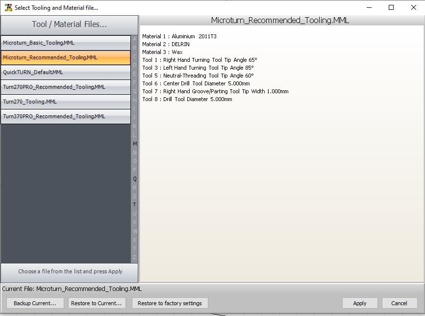

In Quick Tern 2D Design make sure you have the correct tool Library selected which will also create a program cutting from the front.
