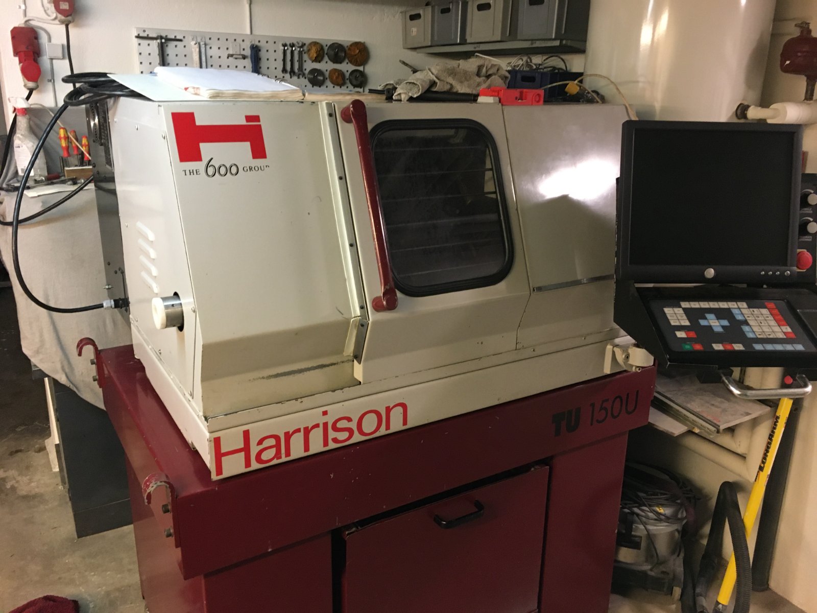

My new lathe

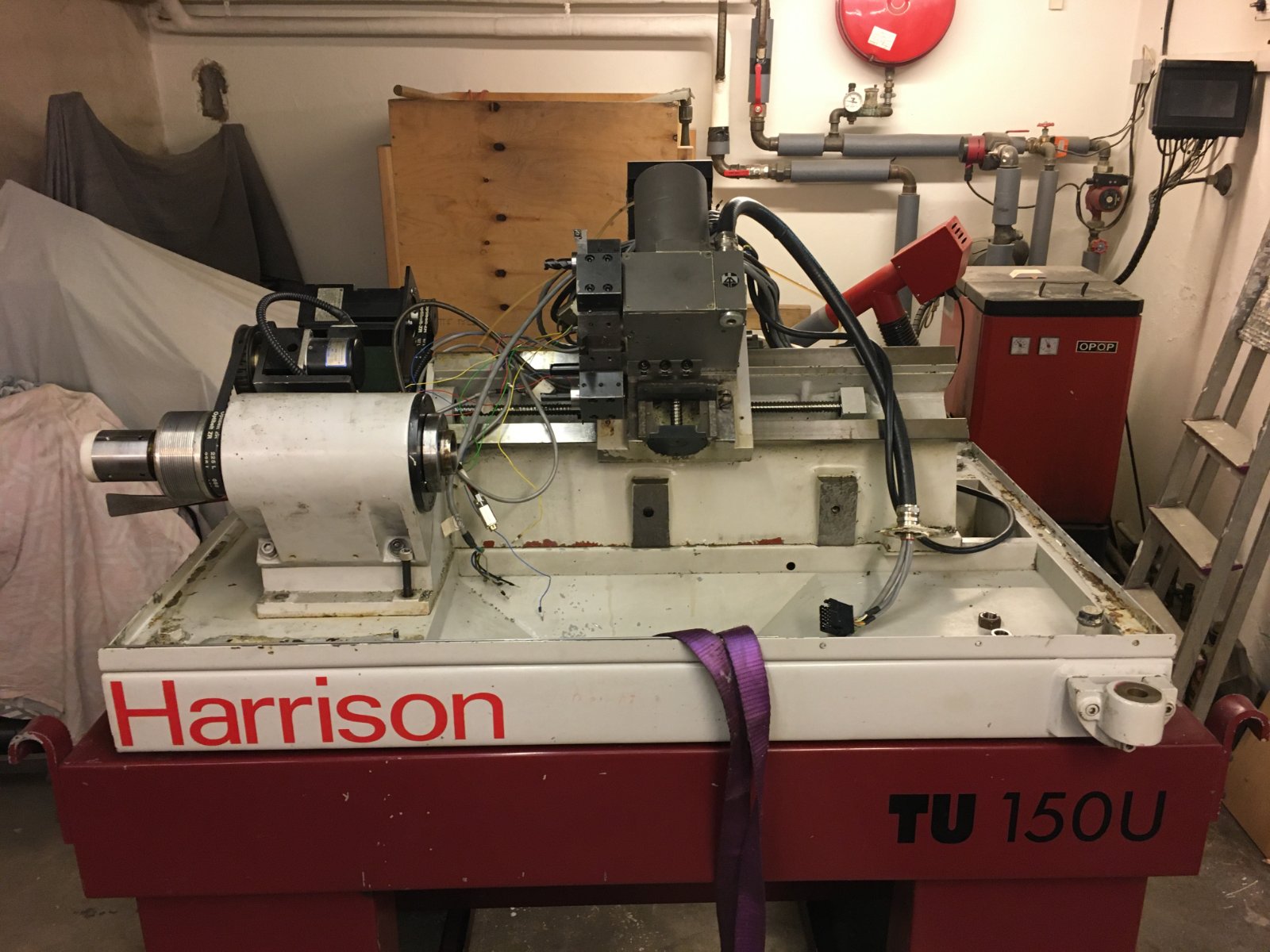

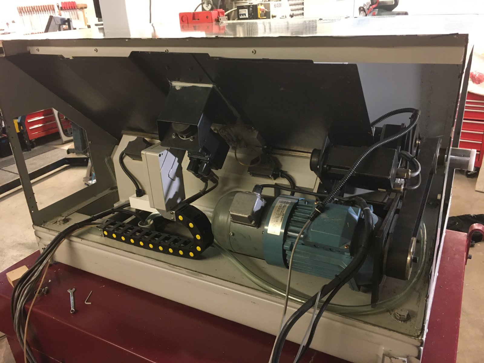

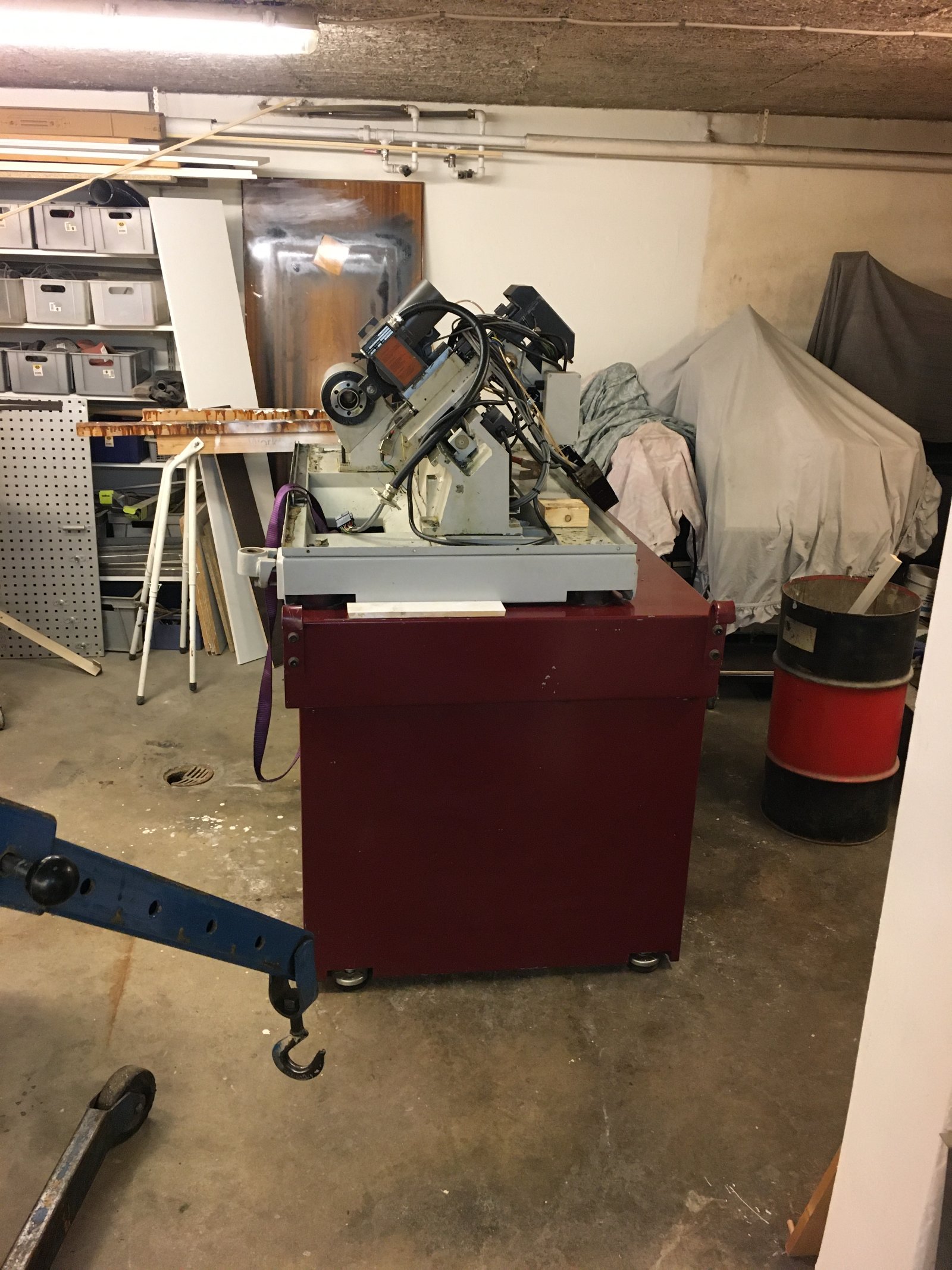

Now this litlle thing has found a new home i my basment :D
Had to disassemle it for the haul down the stairs, a fine opputunity to clean an inspect the bits and pieces
All in all a fine machine, from an techical school in Sweeden

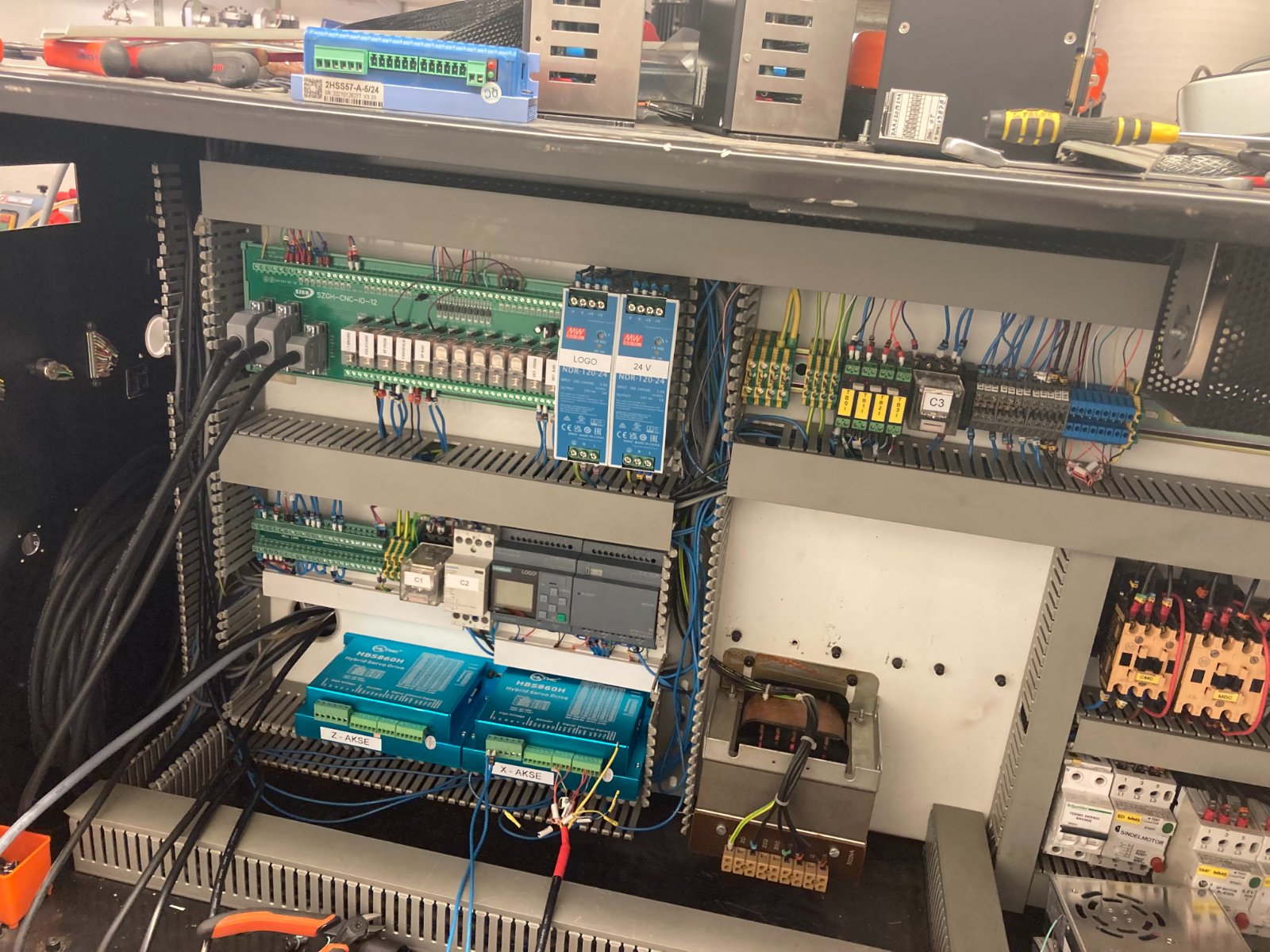

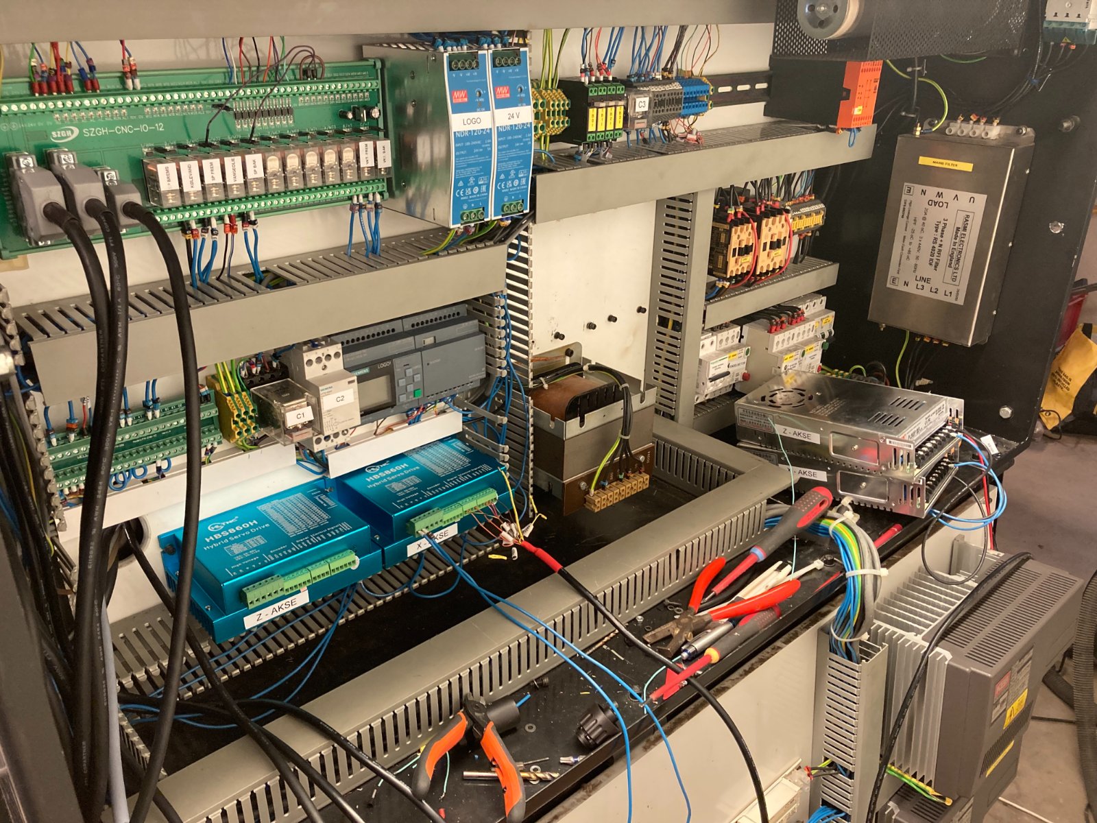

Lather converted with SZHG control

The mascine was from Sweden, im from denmark

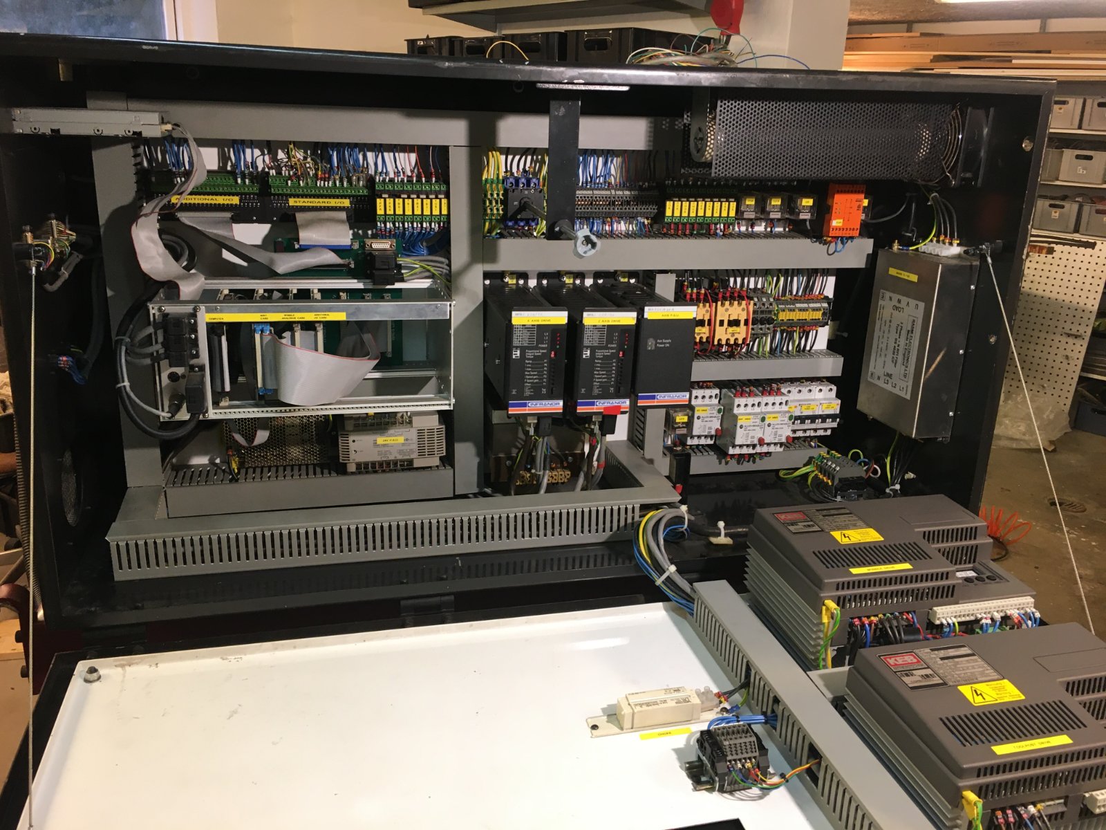

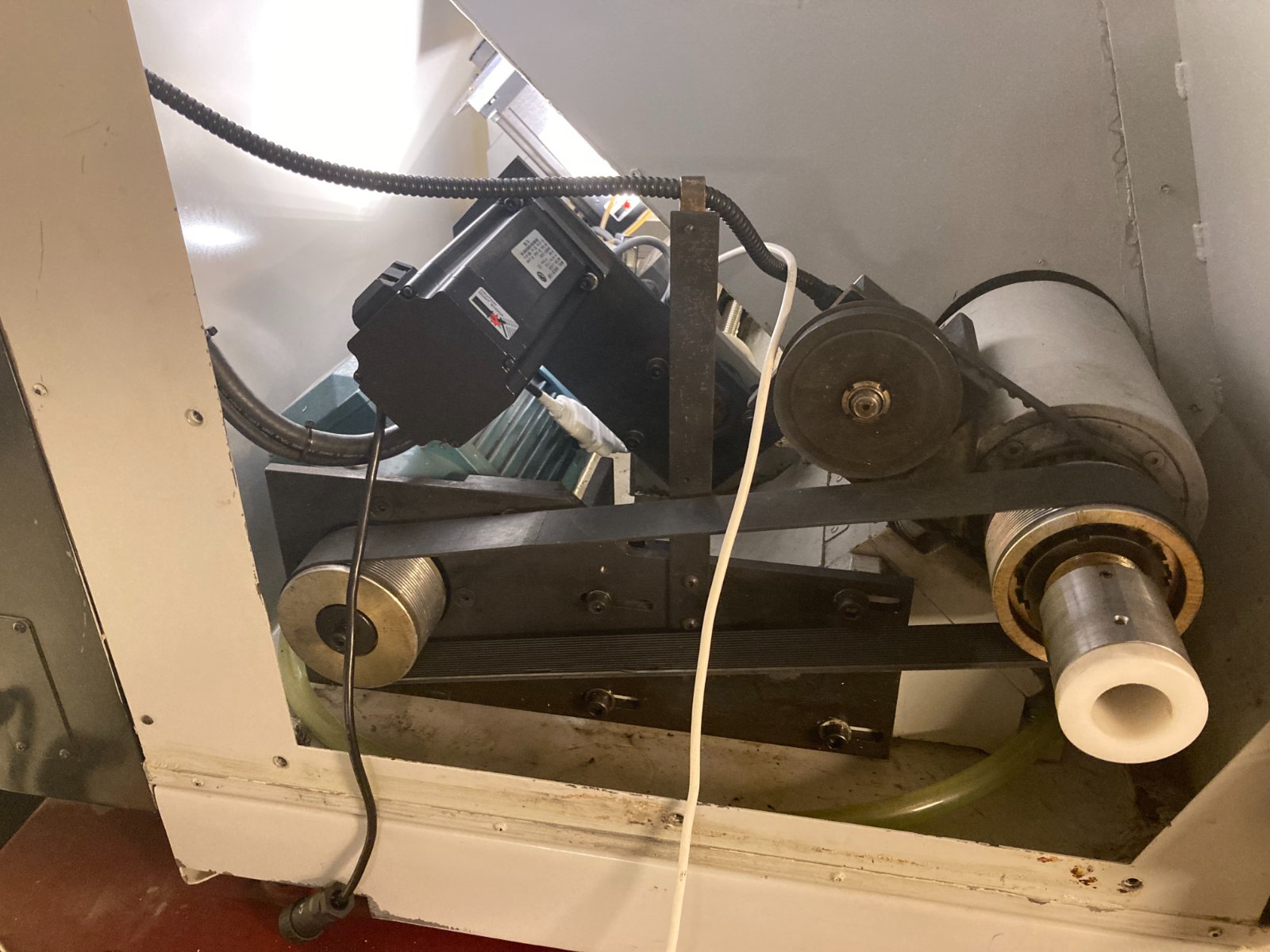

Yep the old pats will be for sale soon, computer / CPU, mintcard, IO card, keyboard, encoder, servos, servodriver and PSU
The cost is about 12.000 Dkr.
SZHG controler and releybord, closedloop steppers with driverand psu, Siemens logo to control toolchanger + small bits and pieces
and lots of hours :D
