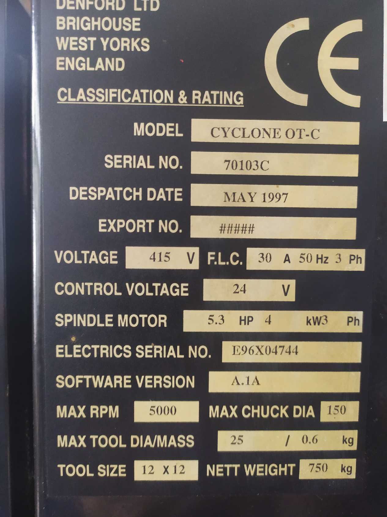

I was asked for help to recover Cyclone TU-150P that doesn't bootup.
As I consulted with the owner, the machine just hanged up when it was working and the man just took the power plug off.
Now the machine is in a state where nothing is displayed on the monitor. Just thin horizontal stripes, doesn't response to panel buttons.
As I suppose based on the action taken by the owner and information read on this forum the software is broken.
Can you someone help me to recover it? Is there any interface except USB (sending data for cutting) by means of which I could connect to and debug or flash firmware? Electronic hardware below the cover looks to be in perfect condition, the owner told me that someone checked that the battery in the back is ok. The machine doesn't contain floppy drive. Just 2 sockets at the back (attachement).

Yes, what picture do you wish me to send?
Fanuc OT-C
Re: Tu150P Fanuc O-T, doesn't bootup - no data on the screen
For now I have these 2
Foto1
Foto1
Foto2
Foto2
